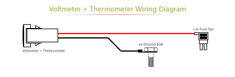

Step 1. Soldering fuse tap and terminal lug
The voltmeter wires are open ended and you'll have to solder fuse tap to positive wire and terminal lug to the negative. This way the installation will be neat and can be reverted anytime.

The voltmeter power cable has M/F wire connector, unplug it and keep the voltmeter aside until you route the wires.
Locate accessories fuse on the fuse box and remove it using fuse puller (Provided in the fuse box). Use the same fuse and install it in fuse tap. Install another fuse (10A or 15A) in the fuse tap for voltmeter.
Once done, put the fuse tap into accessories fuse holder location on the fuse box and make sure it is secure.
To connect negative wire, remove any nearby bolts, insert negative wire lug and fasten the bolt.
Now take out the wire connector from blank socket hole, reconnect the voltmeter and push it back into the hole alone wire. Make sure its not upside-down.
Tie the excess wires to nearby metal holes or rod but far from pedals, ABC cables, steering column.
Few months ago, I have installed dashcam hardwire via fuse tap and now I have used the same fuse tap for voltmeter connection.
