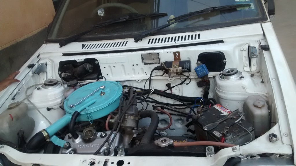

Its been raining cats and dogs in Bangalore for the last few days and on one such evening, I drove around 55kms (inside Blr) in heavy rain and water logged roads, The engine started to overheat and had to stop @ ring road and wait in car for nearly an hour for engine to cool off and then drove back home.

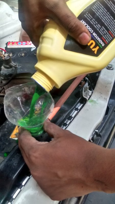

drained coolant

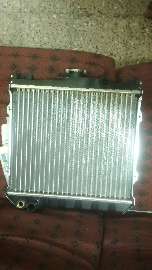

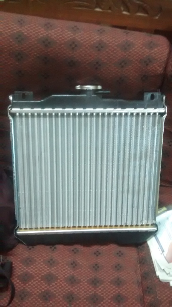

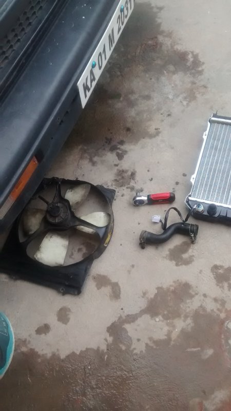

Next day I suspected the radiator leak to be the source of the problem and got a used radiator from scrapyard, cleaned everything, drained old coolant and put back everything. This replacement radiator was an aluminium one, since the fins were bent, not much of cooling, yet again overheating issues, hence came back home, and put back the same old copper radiator back.

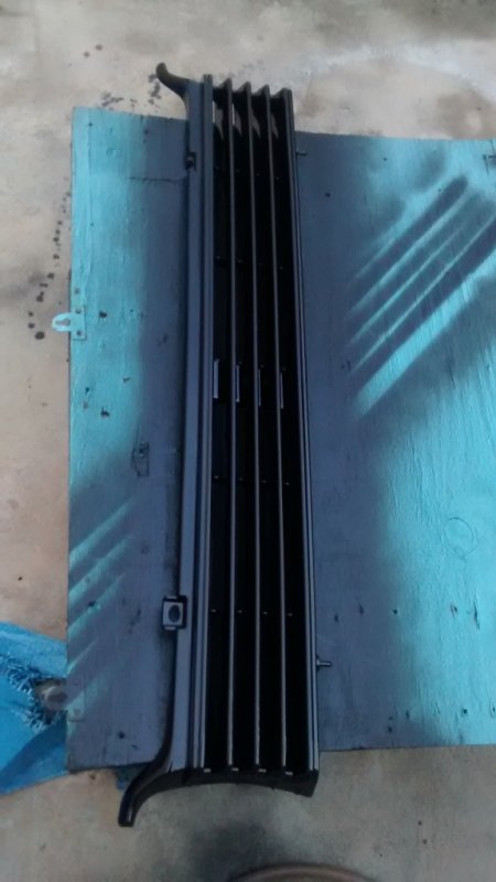

I had a trip (family one) to Tirupattur (TN) about 180kms from Bangalore on Sunday, I left early morning and everything was normal and I was @ 90kmph - 110kmph most of the time, then at the toll gate @ Krishnagiri I found the needle to be almost @ 70% (towards H). Stopped the car, removed grill and opened onnet and let the engine cool for sometime, then again I drove the remaining 80kms without grill, the temp seems to be fine as long as I am @ 50kmph and on highway, once I entered the narrow roads, the temp started to increase and finally I had to stop the car on a lake bund road near Madawala (a small village near Tirupattur) and I heard the coolant bubbling noise from the plastic tank it is stored in
This time I was randonly checking everything to see whats wrong and then called up Varun, he was right the radiator fan was not working at all! Thats why only on highway things were fine, as the early morning breeze cooled the engine, then did a diy and shorted the sensor which controls fan and radiator fan kicks in, permanently ON when key is in ignition slot.
