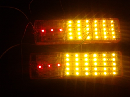

Today again I was stopped by the cops due to the fog lights. [anger] I was not fined, as I had a small LED strip and fixed it in one's bike. They told me to fix it in such a way so that the lamps can't be seen from far. They told that according to the law only 1 pair of fog light is permitted, that too is to be kept covered when not in use. I was willing to make hidden lights, but due to my exams this DIY is postponed. But I am not willing to remove the lamps. I'll change the position of the lamps. [;)]
Please tell me which setup is looking good.
I'll surely remove the fog lights from the indicator's place and make the front indicators more bright.
Dear all please give your valuable inputs.

I feel having slightly bigger fog lamps with 50W bulbs fixed near the indicators (as low as possible) will look good & do a real good job. Are these fogs really lighting up the road? I mean why fix so many lights when one big pair can do a better job. Just sharing my opinion, because those lamps in picture above look too small.
I too was thinking about upgrading the fog lamps.
Yes, these lights light up the road properly. On a normal evening(without fog) the fog light pair is sufficient to light up the road (without headlamps). Autowalas here use singles of these lamps as headlight and the light is sufficient.
The rectangle lights in the indicator's place will be surely removed and the indicator will be there in stock condition. The present fog light is 3.14" and the white ones are 4.3" all with 55W halonix bulbs
Will the fog lights look good here :

I'll replace the indicators soon as the old ones are not properly visible from a distance.
