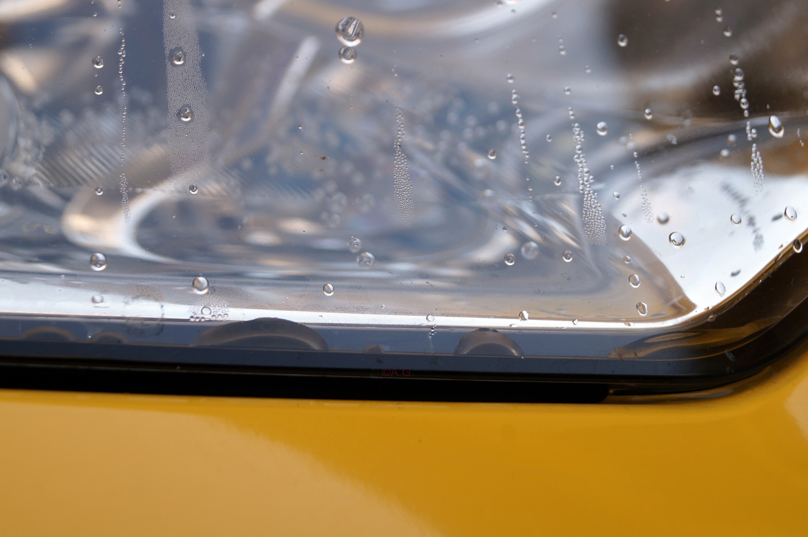

Headlight fogging issue:
The front right headlight started fogging in September 2015 with some water droplets visible inside the unit. Surprisingly, the bulbs upgrade to NBU and the swap to switchback DRL was made months ago after which the unit had sustained heavy rains without any issues. The light was removed and thoroughly inspected for any crack or seal malfunction but nothing was found. Still, water had somehow found it’s path inside the light. I personally suspect water to have been ingested from the seals surrounding the bulbs during engine bay washing for cleaning an oil spill mark at the service as the seals flex with the slightest pressure.
Fortunately there was no damage to the light or the reflector and the same was cleaned and dried thoroughly before refitting.

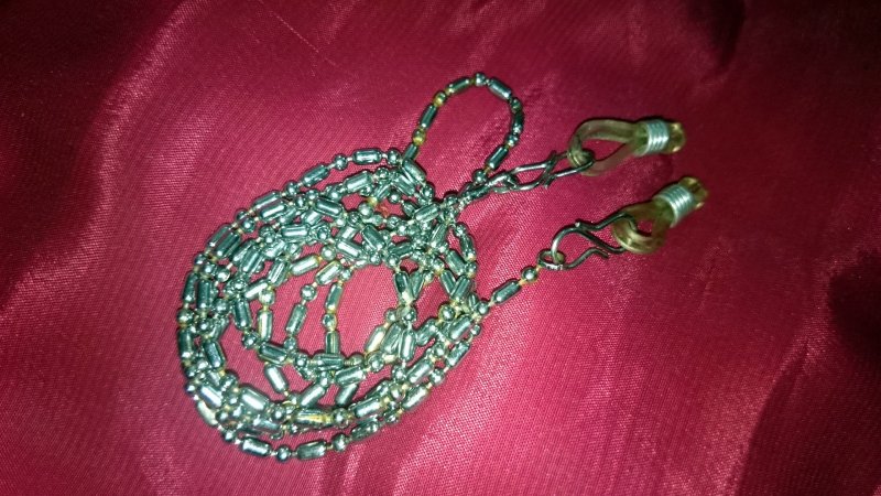

An irritating noise started coming from the rear right side. On opening the inner panel of the Rear Right door, a chain was found inside it. I am still in disbelief how it entered the door panel.

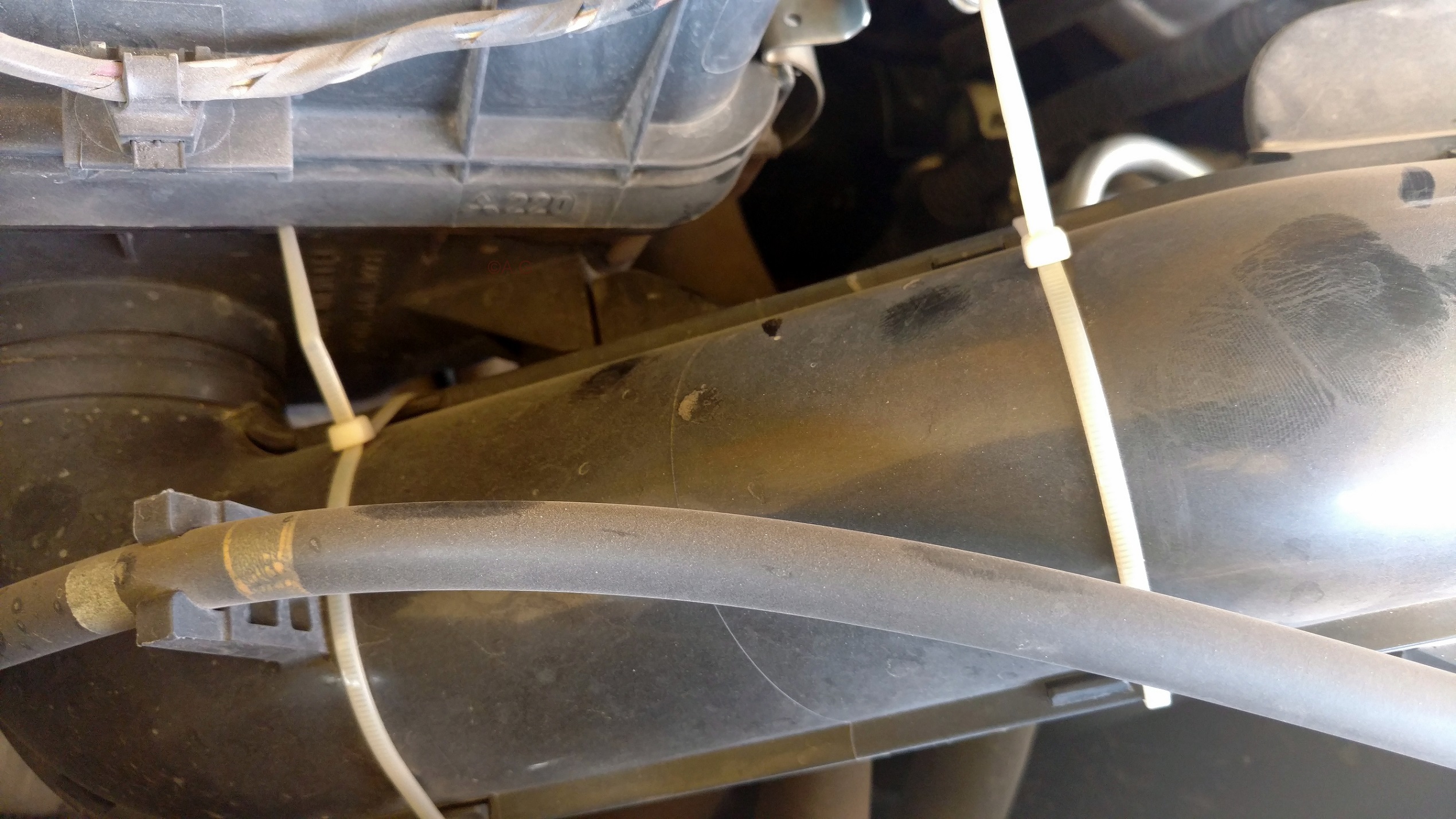

Another rattling noise from the air filter inlet was observed between 1500 to 2000 RPM. This was solved by using 2 tie-wraps to hold prevent the inlet from rattling.
