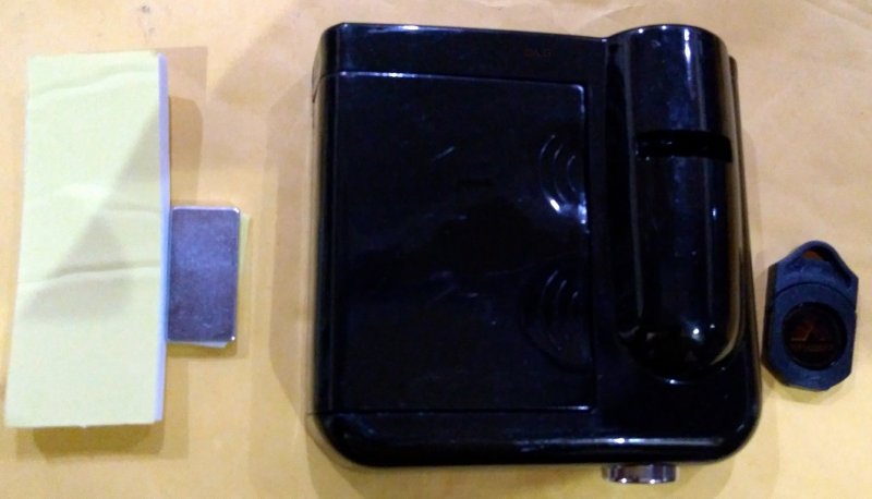

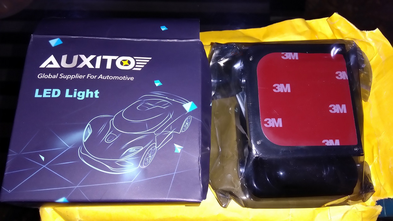

I always wanted to have some illumination in form of a puddle lamp one the door was opened to see where you are stepping out the vehicle in the night. While ordering the LED bulbs, ordered the logo projectors which are externally pasted on the door thus enabling me to revert back to original setup incase the need arises. The only drawback of this setup is that it requires external power in form of 3xAAA batteries on each door and a small magnet to be pasted on the door sill to automatically turn ON/OFF the light.
Package
Contents

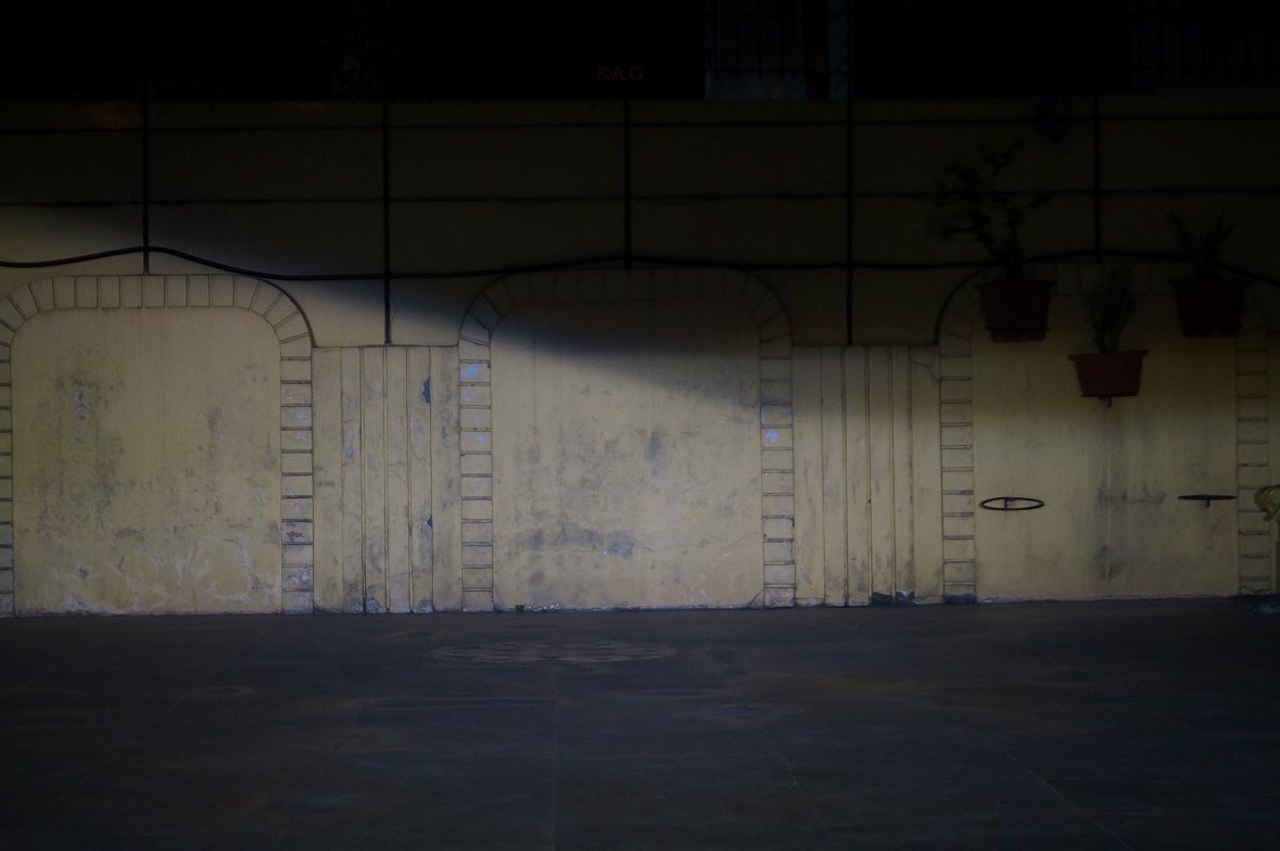

Actual effect
