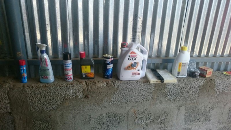

items bought:
oil castrol 20 w 40
oil filter
1 lit anti freeze
half liter dot3 brake fluid
3 liters of distilled water
air filter
cabin air filter
total cost Rs.2160
tools and other items
copper grease
degreaser
rustleak
silicon grease
engine oil flush
new tool added to garage:
hydraulic lift
oil filter remove tool
