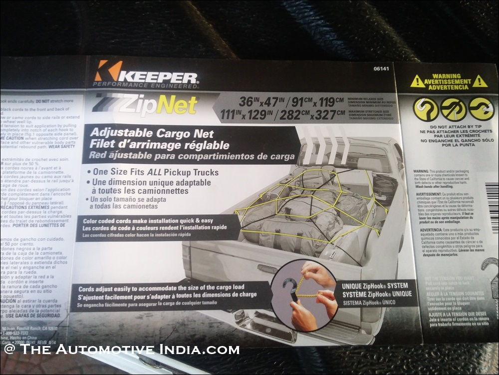

Re: Isuzu D-Max V-Cross Ownership Review: The Japanese Samurai Arrives [8K Kms Crosse
Meanwhile picked up a cargo net for the isuzu bay - the luggage if scarce can move around so this net will come handy. Its elastic and adjustable.
