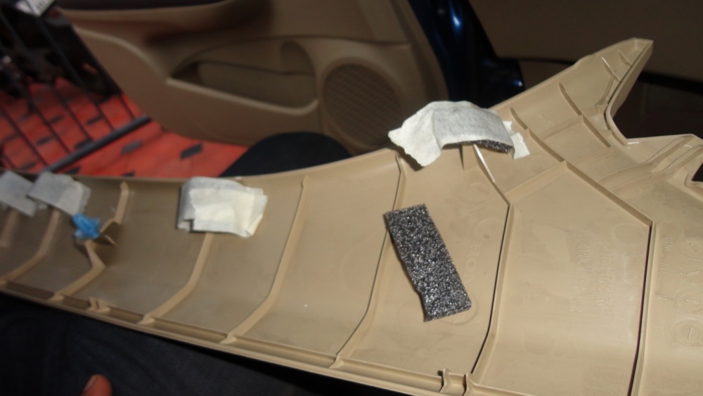

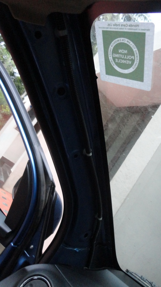

Finally removed the Left side A pillar panel to check out from where the rattling comes. There are only 2 lock's for the A pillar panel and and several plastic moldings which in turn comes in contact with the metal body and hence those plastic moldings made those annoying rattlings.[frustration]
Covered all plastic moldings with Heatlon and duct tape [clap]
Finally got rid of those annoying rattling's !! [clap]
