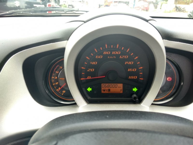

3 Years 4 Months 10 days

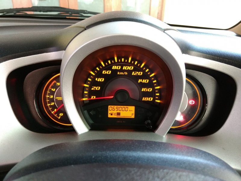

3 Years 6 Months 20 days [:D]
