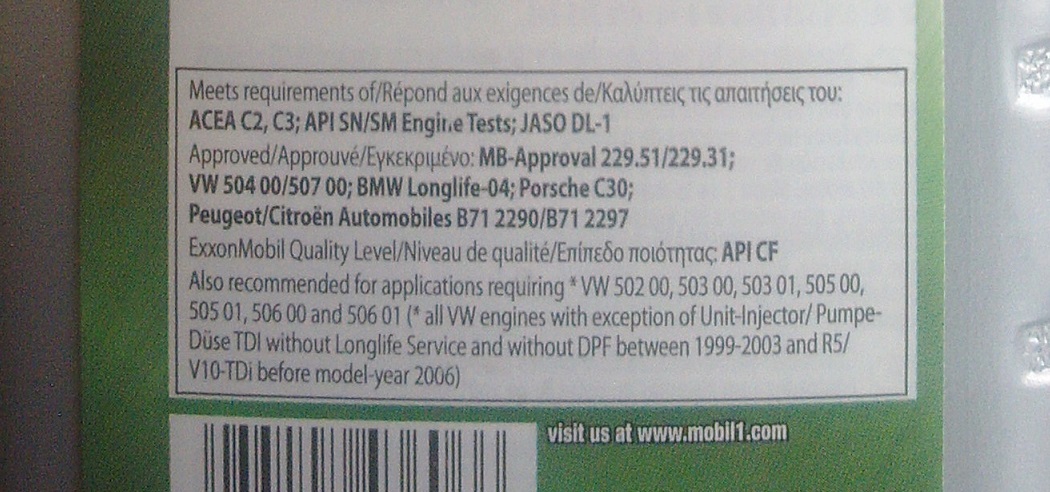

Well, it really depends on the friction rating and consistency of the change in viscosity with temperature. Unfortunately the latter is hard to determine without testing, but friction rating is always mentioned on the bottle (With the notation C_). Where a higher letter is better ie. CF is better than CD.
Thanks for the reply. It's CF, and all else matches, only hitch is that the User's Manual does not say anything about the API. Just in case, ACEA A3/B4 is the rating.

You can check the equivalent API and ACEA ratings online.
ACEA is something the manual states. API is not stated, but I am quite sure that won't be a problem. One last question: Does using higher viscosity oil prove harmful to engines?
