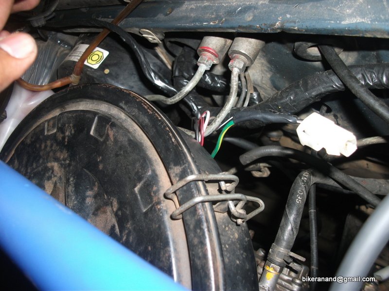

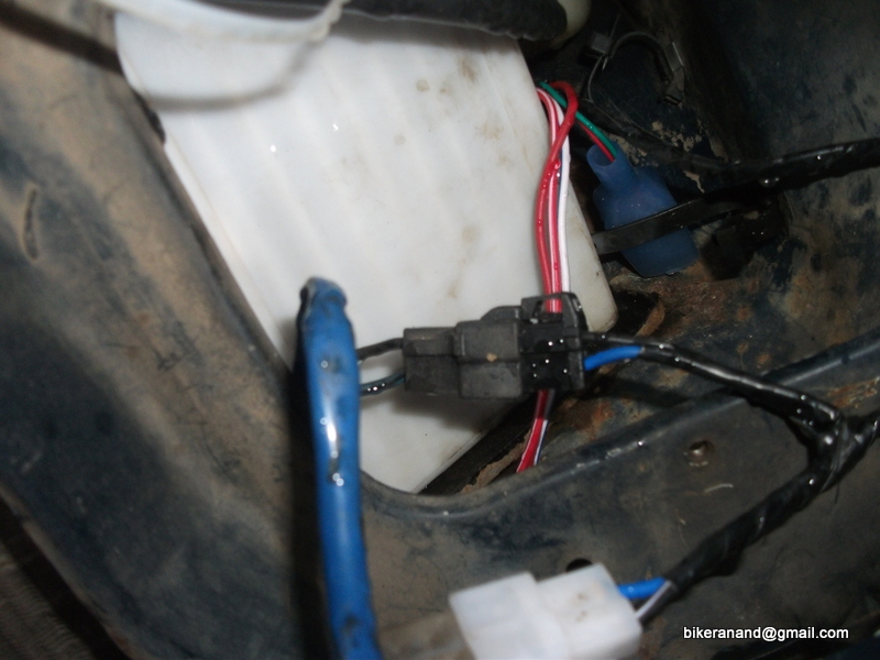

I am taking my car to the Tinker shop tomorow so fixed the driver seat, all electricals (wiring & some bulbs etc) New issues cropped up this time.
Wiring is passed through the chassis area instead of the middle of the floor.
Some mild extensions to be done to the cabin door light wires & handbrake switch connecting wires.
