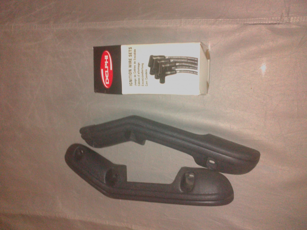

Yes yes, bought the chord kit (Delphi Brand: Rs.260/-) & front two door handles (150/-) and some plastic tags to hold the wiring in place.
Here are some pictures. WIll fit them tomorrow and check if the idling issue is solved.
