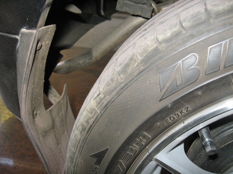

bad:
1. bigger tyres kicking up a lot of dirt on the car have been looking out for a bigger moulded mudflaps but no success so far ( I dont like sparco flaps on my car)
2.The rear tire scraping against the wheel arch with 4 passengers [anger]
I dont want to put spacers. will start a separate thread to discuss this isssue soon.

Better go to a workshop (Mechanic) and get the rear wheel arches hit by a hammer from inside so that they bent out a little bit. My friend did on his esteem when he upgraded to 15"ers.
Regarding the mud flaps, All you can do is to fit the mudflaps of other cars (Indica,etc), if possible. Or, You can pull the mudflaps out ,so that less dirt is thrown up.

I didnt want illuminated sill guards as i wanted to keep it very subtle.
the alloys are 13 inch and the OD of the wheel is same as original but the it is wider by 10mm and thats the reason for it rubbing on the wheel arch.
I am still on the look out for proper fitting moulded mudflaps. I was told MGP has a bigger mudflap for alto i need to check it out.

Just check one thing before doing anything. Remove the mudflaps and see whether its still touching the wheel arches. As it might be a case that the tires are touching the mudflaps and creating the noise.
