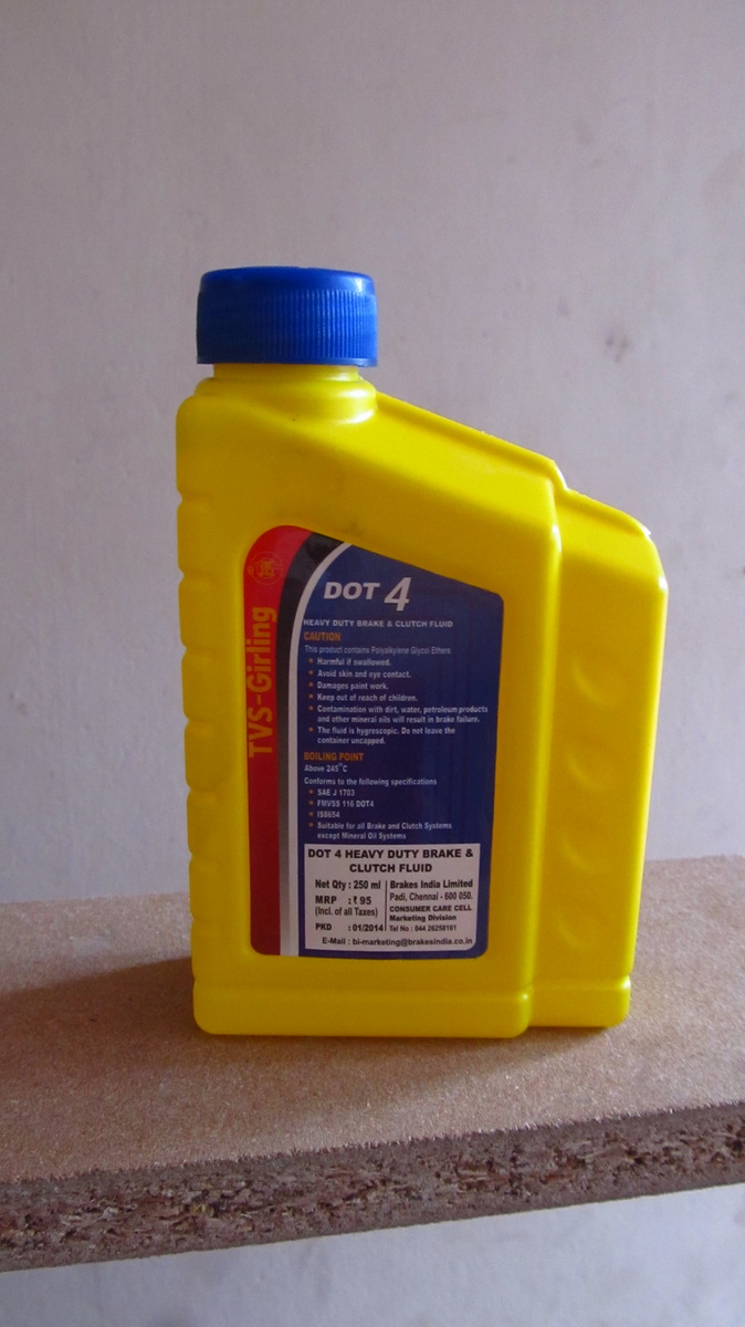

TVS-Girling DOT4 Brake Fluid. 250ml, got for 80 Rs.
Fill and pump.
Till it's hard.

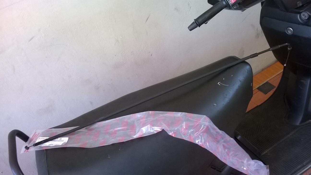

Changed clutch cable as precaution (The night before, @vichu got his cable snapped, in the morning I changed mine). 110 INR, changed DIY
Clutch is now lighter than ever.
