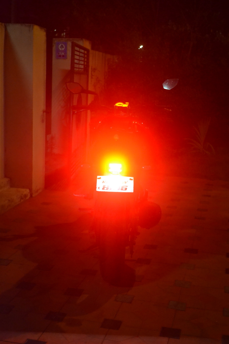

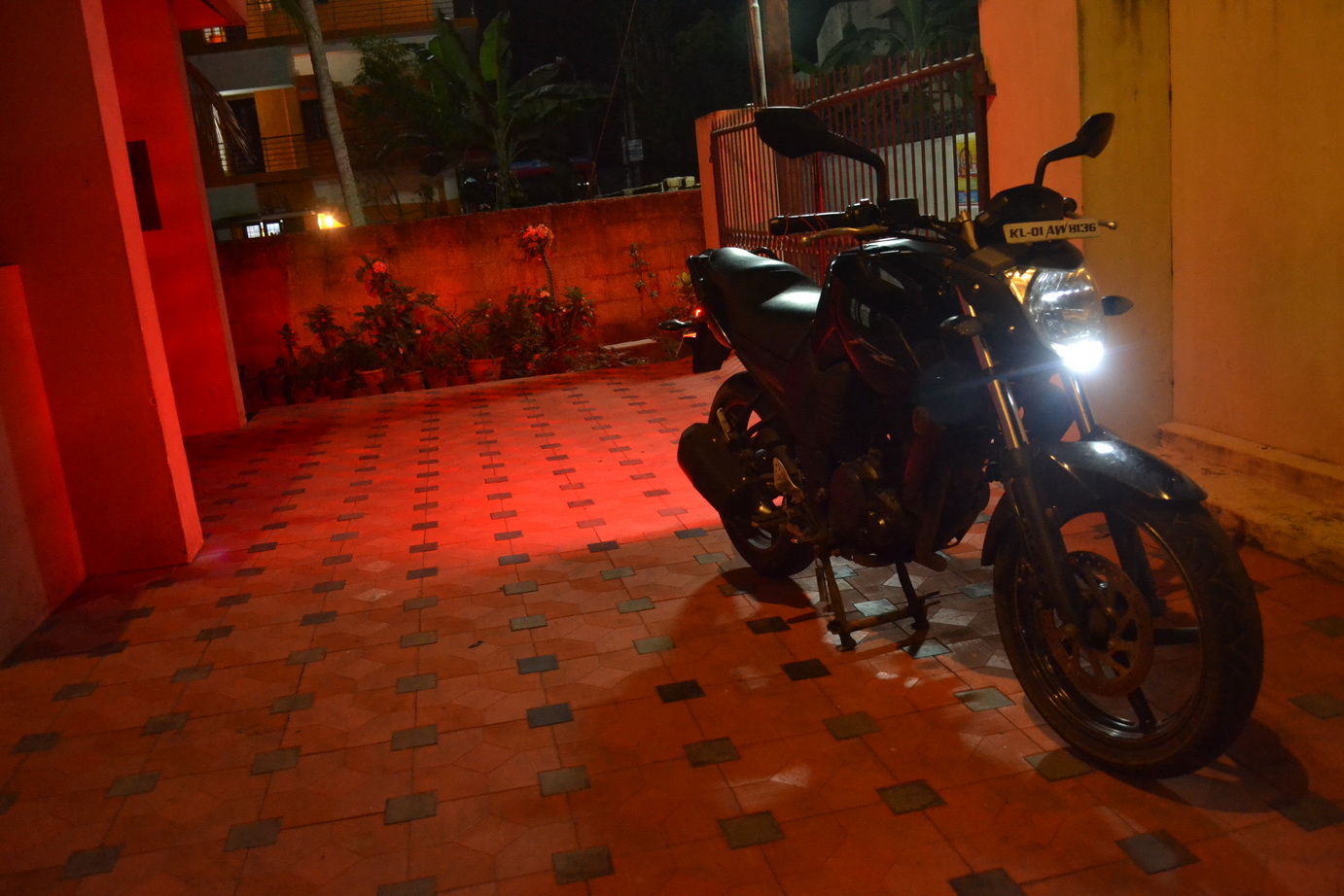

New upgraded LED tail lamps. 36 superflux/piranha LEDs+3 SMD for number plate. More compact than old 96 LED setup. More output.
Less complicated rear. Neater package.
In action.
Rear view.
How it light up the rear [evil]

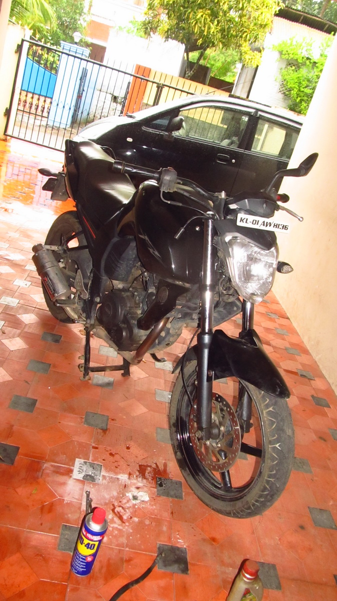

Cleaned up the mess and made it black again.

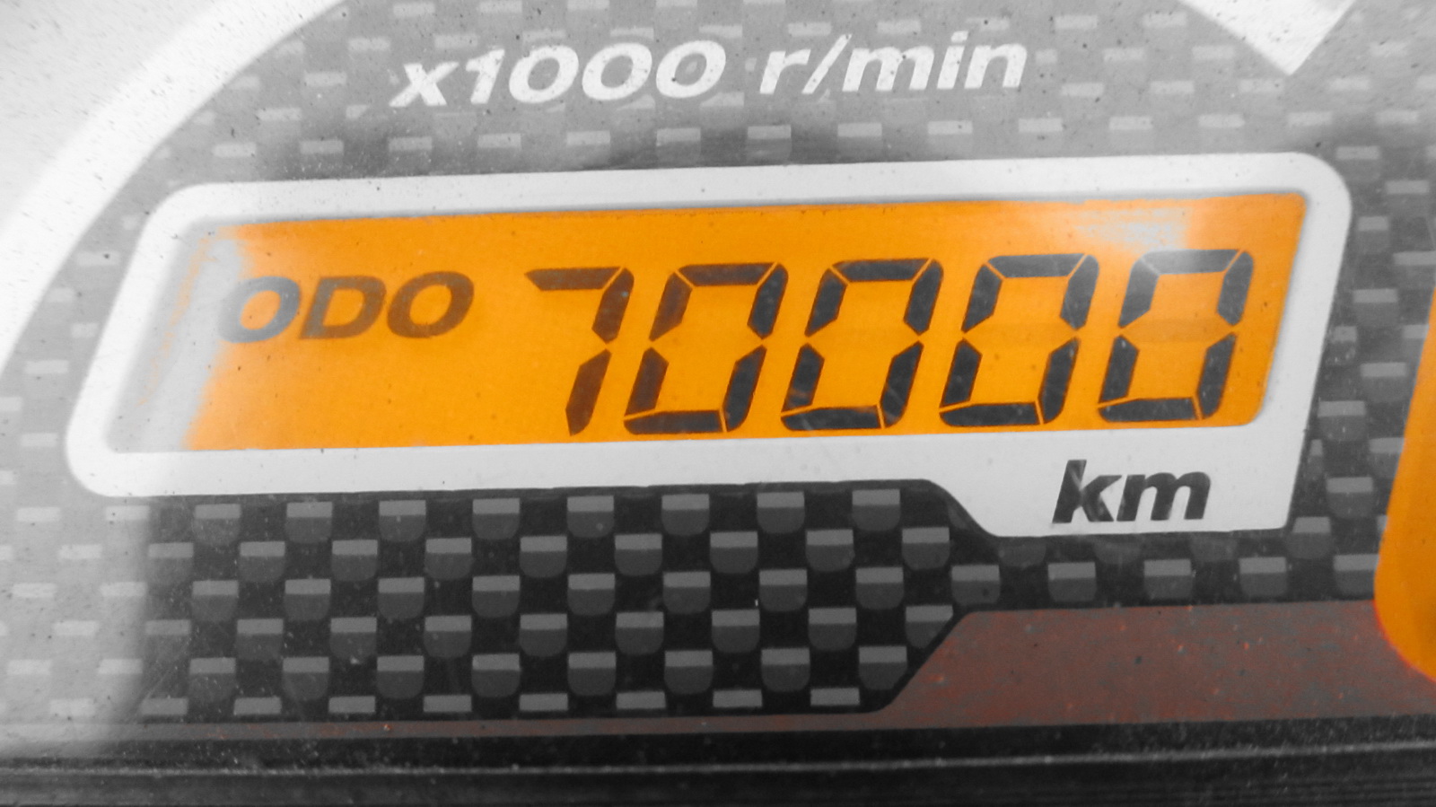

Hit 72k

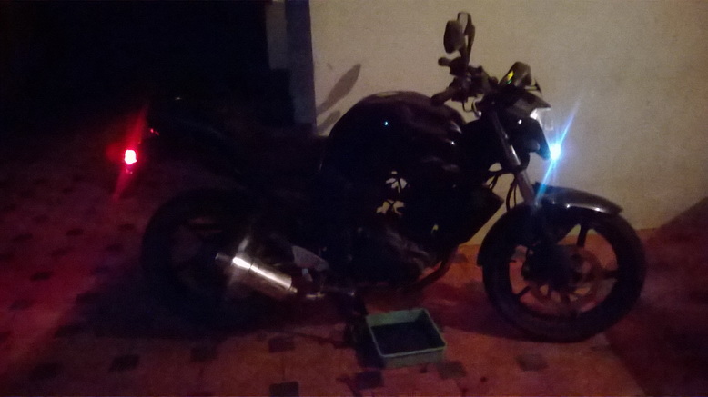

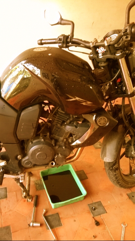

Midnight oil change to accompany an All-India solo bike trip to Cape.
Motul 7100 20W50, MRP 805, got an undisclosable sweat deal [evil]

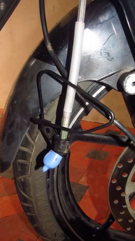

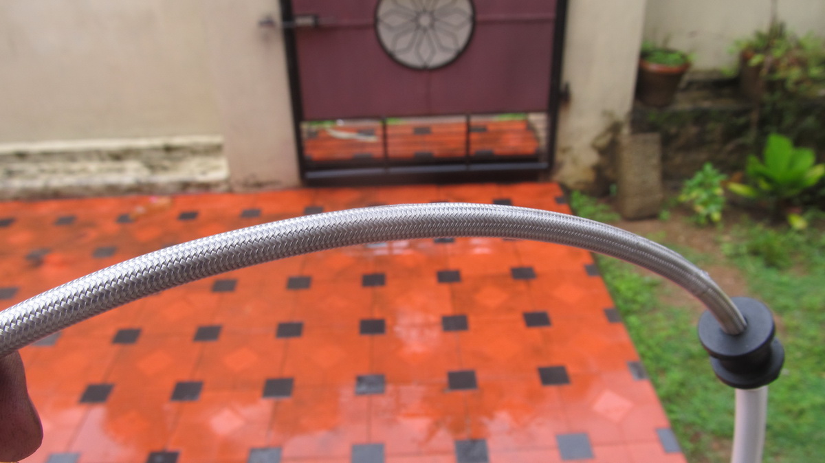

Brake Hose Upgrade. Steel Braided Hose from Pulsar 220. MRP 1109
Fine Monday Morning. It's DIY time.
Brake fluid drained and full brake assembly stripped.
All parts cleaned and ready for fresh install.
Old rubber hose and new steel-braided hose. New one is slightly short and tight fit.
Stripped away the protective plastic cover. Love the exposed steel look.

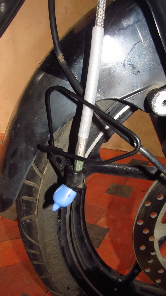

Routed the hose.
Clamps swapped from old hose.

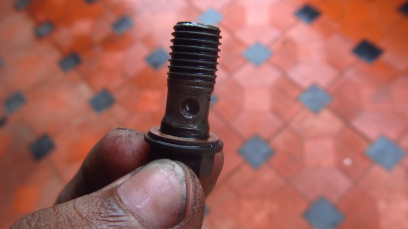

Banjo bolt.
