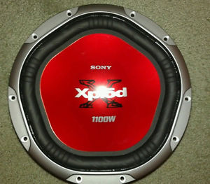

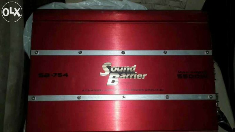

Hello everybody,
I have some enquiries regarding the audio system in my car . I have the following setup
4 Rockford Fosgate P1675
6.75" 3-Way Full-Range Speaker ( one on each door)
Pioneer 2690 BT head unit
Sony Subwoofer 1100 watt
JBL Bass Enclosure 1100 watt
Sound Barrier 4 channel Amplifier
Alpine 4 channel amplifier .
Till now i have been just using the sony subwoofer with the alpine amp but now i am also adding the jbl and sound barrier amplifier. I have been using the speakers without the amplifier as someone told me that they damage the speakers in long run . Please suggest me that i should connect my speakers to the amplifiers, will it enhance the experience and won't they damage it. Moreover i am not aware that are the speakers capable enough to take the amp. I am providing the specs of the speakers and also the link. Moreover also suggest me that should i get the pioneer ts-20. Kindly also suggest that which with woofer i should pair the amp and with which the speakers. Kindly also suggest as nice wiring kit.

Assuming that you are having the chinese Alpine (local-made), it would put out nothing more than 75w per channel. Driving 55w speakers is not a problem. The speakers which get damaged in the long run are those which are run at extremely high volumes for long periods or those which are fed with lots of power (say 125w for a 20w speaker).
Having two different subwoofers will ruin your soundstage. Both the woofers will have different specifications, one will respond faster and the other would hit harder, there are so many parameters and you will end up cancelling the bass lines from 1 subwoofer with the others'. This would not give precise definite bass, sort of like hearing 2 car audio setups at the same time. Either have both Sony or both JBL.
Why do you feel the need for the TS20?
I feel both the Sound Barrier and Alpine amps are chinese and are the weak link for your system. Which equipment do you already have? And what is your precise requirement from the system and whats the budget? Do you already have all these fitted in your car? If possible, share the specs of the amplifiers. Powering the speakers with an amplifier that has both LPF and HPF settings would be a wise idea.
Get a Fusion wiring kit, or better would be JBL, Bull Audio or Scosche 8 Gauge but at double the cost of Fusion. Avoid cheap eBay kits as wiring is indeed an important part of ICE.

Thanks for the detailed reply
I also somewhat feel that the amplifiers are week point... And yes I got them installed with the fusion wiring kit. I am getting a good bass but the audio quality is not satisfying as that day they hurried up so the settings are yet to be done.. I will go there tomorrow and get it fixed up.. Kindly recommend the amplifiers please. The current setting is that he has out paired each amp with two speakers and one subwoofer so that there is no load. Kindly comment on that also. And to get better output what do you recommend should I remove the sony subwoofer and use just the jbl and pair one amplifier with it and other with the speakers..

Do look up on both the amplifiers and let me know what all settings are there, I will help you. Installers basically jack up the bass with the amplifier's settings which is harmful for the subwoofer (if it cannot take all that power) and amplifier (overheating issue).
If you are ready to change both the amplifiers, get 2 four channel amplifiers. One to drive your speakers (which should have minimum 55w x4 RMS power) from any good brand like Kenwood, Pioneer, JBL or even Sony. The other one to drive your subwoofers (2 channels bridged for each subwoofer) which should have slightly higher rating around 70-80w RMS per channel. You can select the brand and power output depending on your budget. Price would start from 4k anyway per amp.
Regarding the load part, this is where he has done it wrong. It would not help with the load in the current wiring also as the bridged output of the 2 channels (of sub) of each amp are actually 2 individual single channel outputs combined together. Infact this is messing your sound quality as one subwoofer is getting more/less power than the other as the amps are not having the same specs (or are identical). Same case with your speakers also, one set would be getting more/less power than the other. Get all 4 speakers on one amplifier and both subwoofers on one.
See what price you can get from the Sony subwoofer. You can exchange it for a grey market JBL subwoofer (same model as what you have) and enjoy your music! It is because 2 of your channels would be left idle if you use only one subwoofer.
You know what I would personally suggest?
Sell off both the amplifiers, sell of the Sony woofer.
Buy a 4 channel amplifier from good brand with around 55w RMS per channel and pair all the speakers with this amp. Next buy a 2 channel amp with 70-75w RMS and put the JBL subwoofer on it. This way you'll enjoy your music in great quality without mess.
