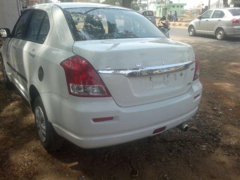

Hi Sankar,
I managed to gather a few pictures of a Dzire Tour converted to VDI, for your reference[clap]
Cheers,
Anshuman

Hi Sankar,
Cheers,
Anshuman
Thanks a lot Anshuman. Car looks exactly like Dzire VDi. Only difference is the white color used by Maruti for Dzire Tour. Dzire Tour comes in ordinary non metallic color called Arctic white while the old gen Dzire VDi comes with metallic white color called Superior white. I inquired about changing my car to metallic white but the costs exceeds 35k for the whole car so backed off.
Have you had a chance to look into the interiors? Did the owner change any interiors?
Regards,
Sankar
