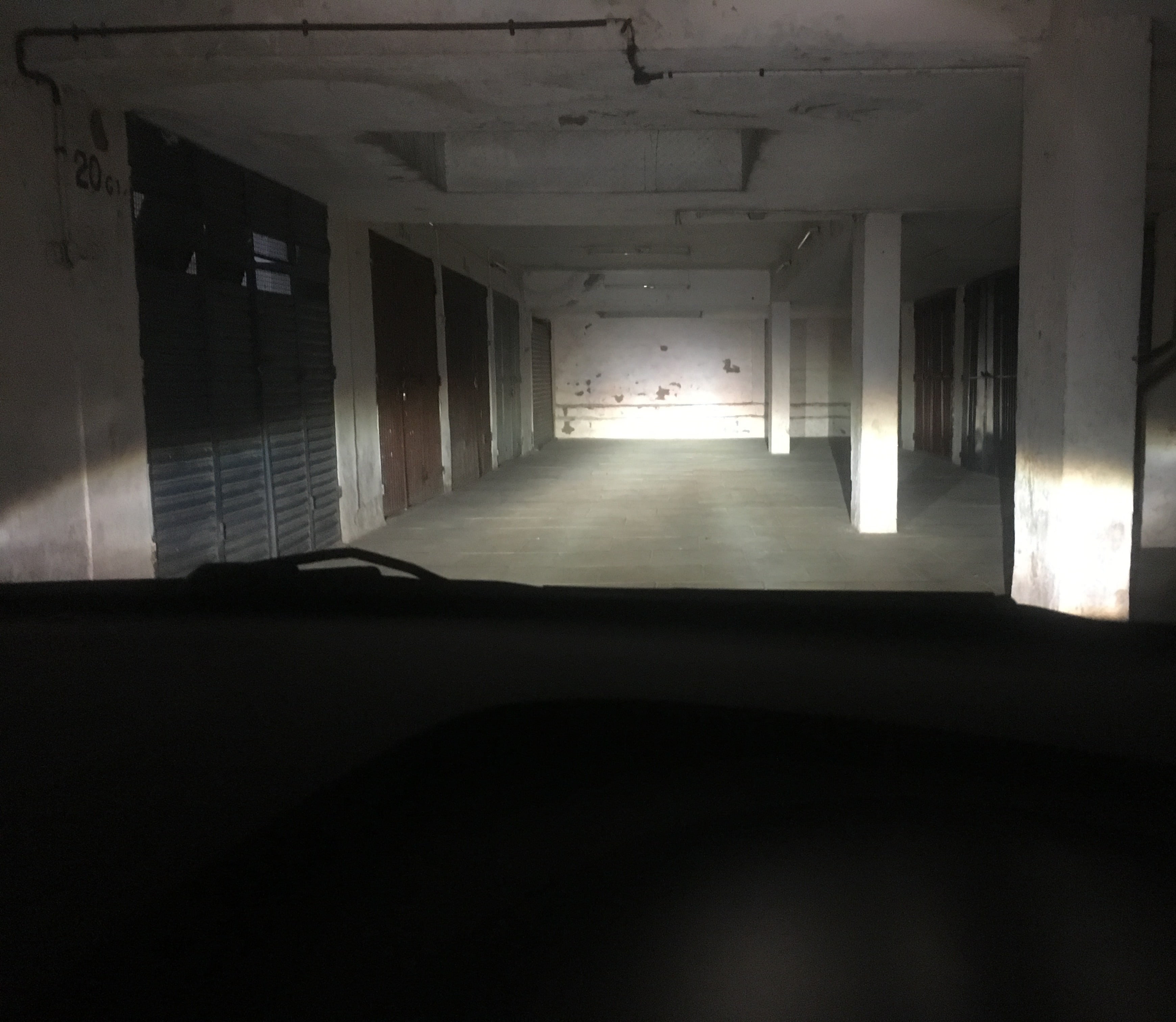

Guys just an update got a 4300K 55W HID kit put for my car when I got my ICE upgraded last weekend. The light is excellent. Have just low beam pictures for now, shall post more soon. Thank you bhvm for your guidance.
P.S : The picture says 6000k but it is just for reference and have actually put 4300k itself.

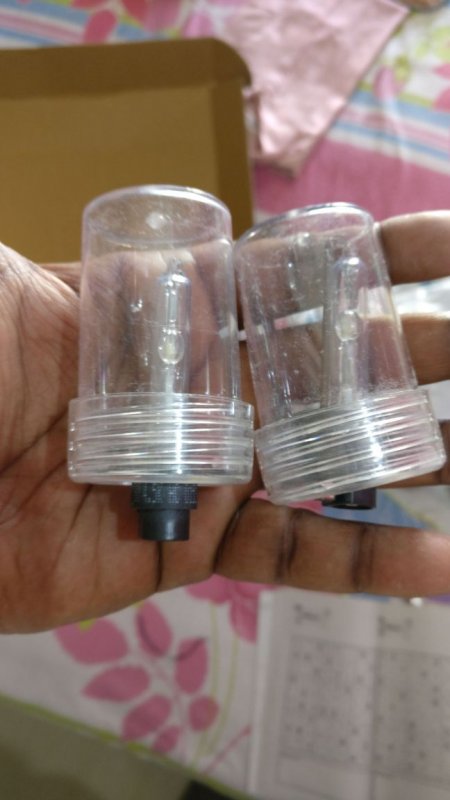

I had again went to the showroom for some work and I wanted to see the bulb and is this bend normal ? [lol]
I asked him if the ballast is AC or DC (it's not mentioned ) he said there's nothing like that. So the guy just refuses anything he doesn't know.
And today he quoted me 13k for these.

AHC, this is extremely poor quality bulb not even worth 1.3k, let alone 13k
And dark blue return wire means that its 8000k.
In the first page of this thread you can see pictorials about picking up right quality bulb.

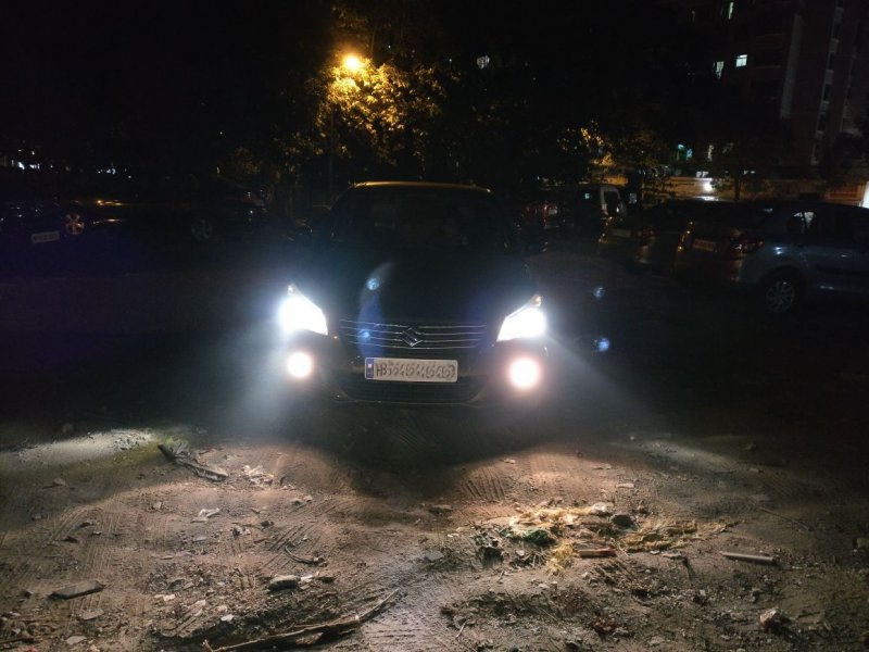

Today after a long wait I got my shipment of HID's and ballasts from UGLARE.
Bulb type: H7,
Color temp : 4500 kelvins
Ballast: 35 watts quick start + canbus
The packaging was slightly damaged in transit as you all can see from the pics, but the bulbs are working fine.
Installation was a DIY, My first [clap] DIY.
I think I need to align my left and right side headlamps a bit.
The HID's were installed in the low beam projectors. High beam and fogs are regular halogen bulbs.
Please ignore the dirty engine bay [lol]
