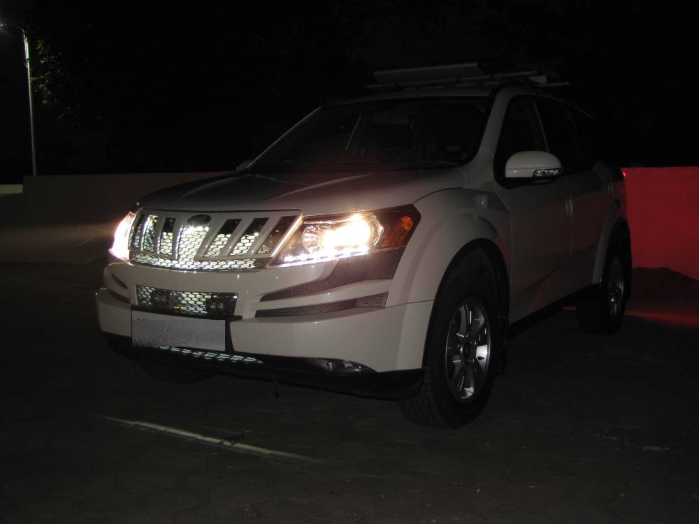

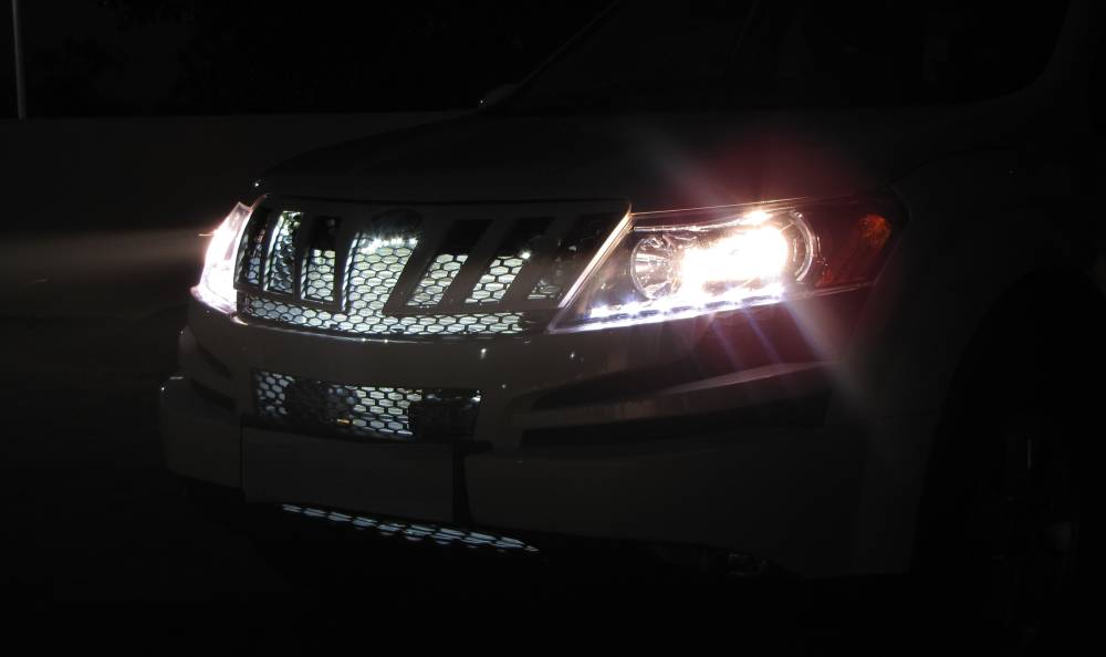

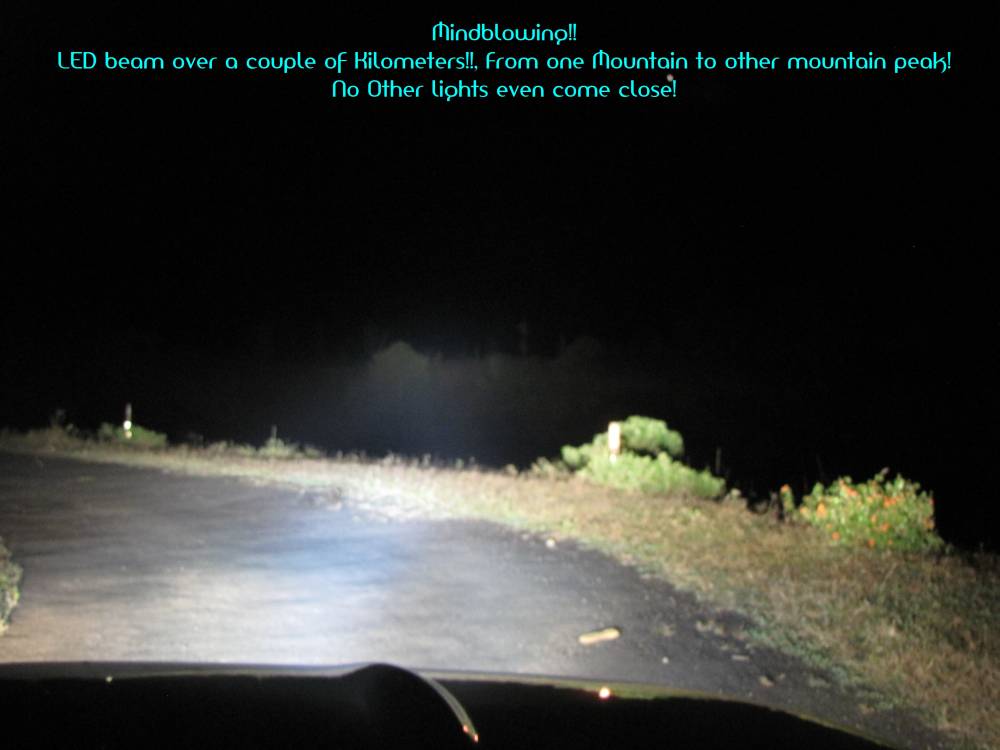

Re: “Thunderbolt” XUV 5OO Detailed Review (Decals, Audio, LED, Mods++)
I am pleased to Report that, The club Mahindra Folks have extended the Validity of my Holiday voucher. However, I am not being given a new voucher or some sort of screen print to proove it. The person said that he has entered the date into his Computer. Please guide me on this folks! I have shot an email regarding the same.
Now, as promised The pics![evil]
These are some links to my instrutables account, Please don't Mind folks. Running outta Time and Internet Balance!
LED Grille Illumination-
LED HEADLIGHTS-
PICS are taken in MANUAL mode(Same settings and on Tripod). if you feel that the LED Pics are TOO bright, Thats because They're! You can drive with these LEDs alone and keep headlights off. No Problem.
Head over to Blaze N Bright - LEDs for your SUV/Car/Auto or Home.BUY LED INDIA to buy such LEDs.
Hey, This website link doesnt seem to work.
I need to beef up the lighting for my XUV 500. is there any other link or do any one know of another vendor?
LED is awesome!
