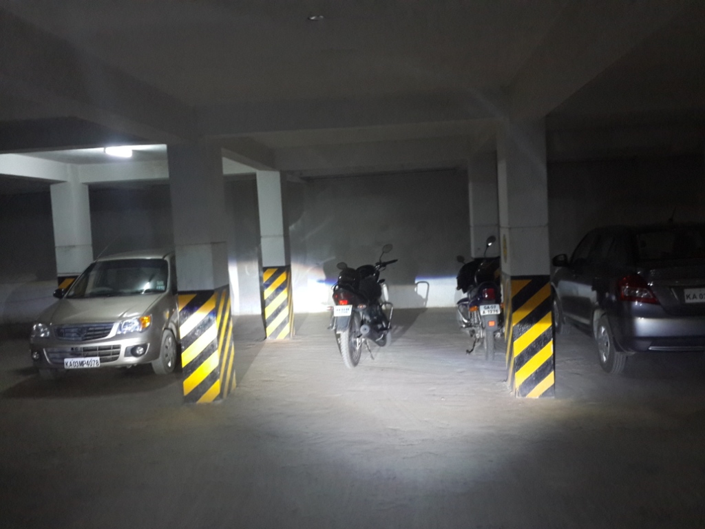

I don't know if it's the camera but your hids look somewhat green. I guess you brought 6000k which should look like your basement tube lights (white ) and not green.
Good find bhvm..[clap] on seeing your message i thought it could be a problem with my mobile camera white balance as it is set to Auto mode. But seeing at the greenish tint then realized the reason due to 3M CR-70 sunfilm on the windshield. Now taken the pic again from out of the car, you can notice the difference [:D]

that's a Lovely pic tm!
just look at the rainbow like strip near the cutoffs! Beautiful! any problems with cops due to your 'white' lights?
There is no problem till now. I too dont see any cops starring at these lights. The lights have a slight bluish line at the border, other than that it looks bright white.
I think Since it is on projector it may look like OEM lights. As some car like range rovers has pure white LED lights and same whitish color with BMW rings as well. And the white LEDs in XUV compliment the HID to look more like factory fitted [:D] So mostly cops may think it is normal.
