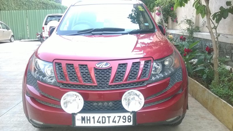

I have been using Philips HID 35W 6000K on my low beam and the throw is pretty awesome. I have driven in heavy rains and I felt no issues in visibility compared to halogens. They are really easy to install very much like a plug and play !
I also use Hella 3003 Rallye connected to my high beam and the result is just fantastic. Since I do a lot of highways having an auxiliary light makes me more confident.

As for installing this was my last month's DIY Project, I have drilled holes on the front impact bars and bolted them using a thick nut & bolt. I have used a oval shape pipe for mounting the lamps and they don't shake at all even on potholes ! Do not use any kind of flat type iron for the lamps as they always tend to shake no matter how thick you get them.
I have actually welded the clamps on the iron piece so that there is not visual of the bolt protruding and then got it powder coated.
Since I am very skeptical about wiring and the way it should be done so I took the liberty of doing the wiring too by myself.

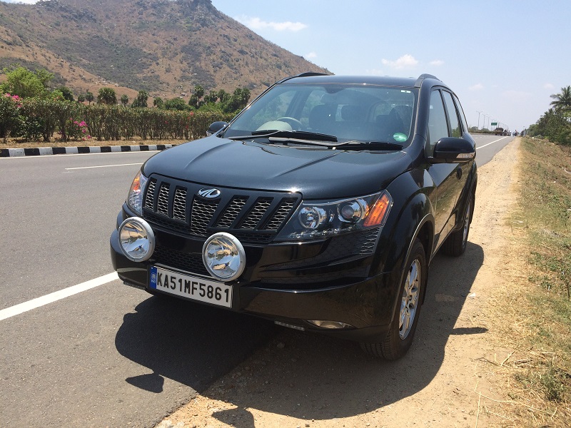

Hey guys got the Hella Rallye 700FFs installed on mine. The daylight beam looks promising in a dark parking lo. Still need to check out the night time beams.
Will Update soon with beam pics.

There was nothing in WIP pics.
All they did was fabricate an 8 inch by 1.5inch Iron plate. drilled 2 holes in it on either side. Drilled one hole in the Crossmember right behind the grill bolted the iron strip to the cross memberand bolted the Hella Light on the other sied.
For the wiring they refered to the Hella manual did it as per it. took the switch and mounted it on the lower dashboard panel behind the steering.
For the wire in XUV there is a rubber grommet behind the engine cover. it was cut slightly and the wires went in from there to the rear of the center console.
Let me know if any more info is required. I will be going on a long drive tomorrow so should get a proper chance to test the lights on the highway.

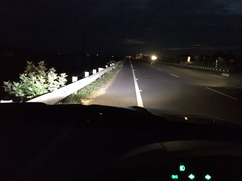

Update on the Output of the installed HID. Sorry i have not taken a picture with OEM lighting.
So exact comparison with the pics are not possible.
Hawk HID kit (It is one other unbranded HID Kit)
At Outter Ring Road, during blackout
Basement - without headlights ON
With Low Beams HID ON
With High Beam Osram Night breaker unlimited ON
With Low HID and High Beam Osram Night breaker unlimited ON
