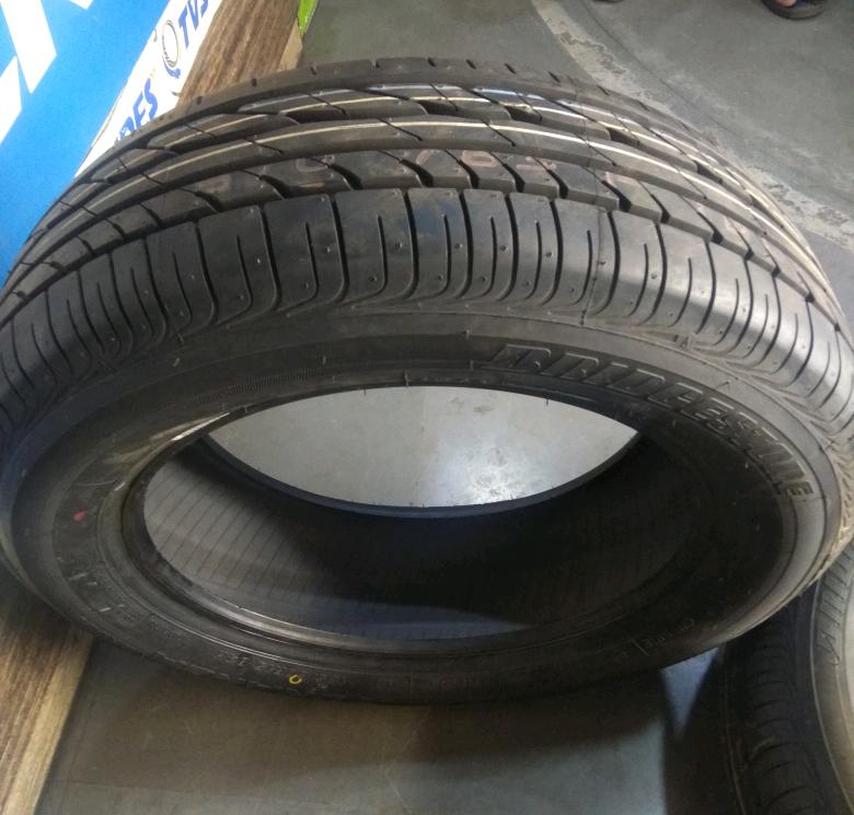

Finally. installed Bridgestone ER300. ₹5200 /tire.
My only grouse against CC5 was that it use to pass details of smallest visible irregularities on the road to the cabin. With ER 300( manufactured in 7 th week of 2018) this problem seems to be decreed by 80%.
So far ran 40 km.

So far ran 300 km, happy with new BS ER300 engulfs all mild to moderate irregularities on the road.
SUPPLE RIDE QUALITY though there is little bit lack of precision during hard cornering as compared to CC5. Still better than apollo alnacs. rps20180329_001035.jpg
Manufacturing date code is 0718.
