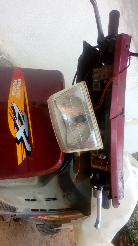

hi deville 56 i also have a kinetic honda zx 1998 model stock condition it was previously running on spaco phbc18 carb
if you dont find choke cable if
you want autochoke
go to the scrap yard and get a kei hin i recently buyed a carb i cleaned it and it started right away
