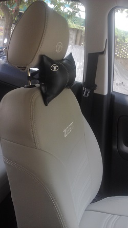

Here are a few pictures of my volvo bus.
The accessories I have installed are from tata's genuine zest kit which includes
1)Mud flaps
2)Seat covers
3)Neck Rests
4)Car cover
5)Sun glass holder
6)Perfume (gel type)
7)Foot mats
Apart from the kit I got separately
-Reverse Camera from Tata which was installed at the showroom itself
-Mobile charger
