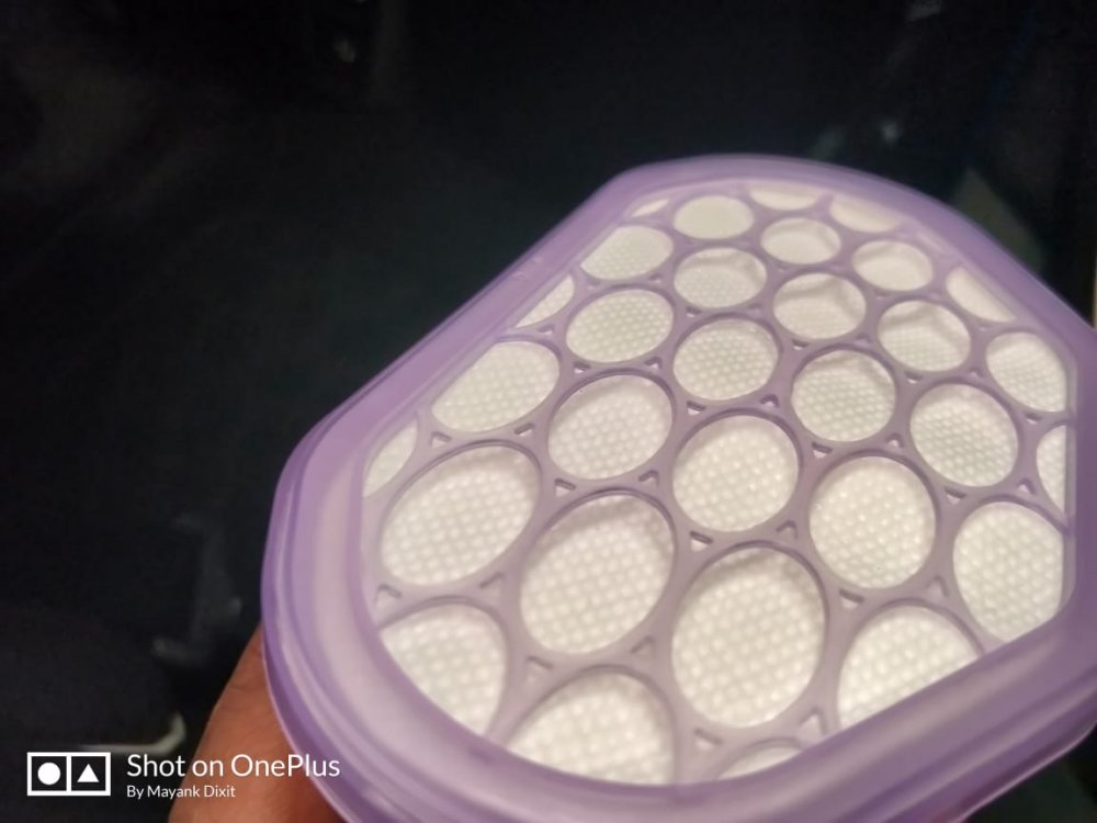

Followed up advice of @bhvm. Thanks to you. Seems to be working well.
Put up a de-humidifier in the car. Water /moisture gets collected separately, in the lower chamber,and can be seen on shaking the jar,as shown in the last pic.
Now no issue with frosty windows. They remain clean and clear even after parking in rains.
  • Dehumidifier jar is designed to remove dampness & humidity from the air in your car or home
  • The hydrophilic crystals helps to retain moisture from air and helps combat condensation, damp rooms, allergens in the air, mould, mildew
  • Easy to use. Ideal for cars, boats, garages
  • The first drop appears within 1 - 3 weeks depending on the humidity level. Absorbs up to 3 times it's own weight in water
  • Depending on the humidity level, the product will last between 4 - 6 weeks
  • Spill proof, comes with a revolutionary one way filter which doesnt allow trapped moisture to spill out of the box
  • Fragrance free and lasts for over 4 months
the dehumidifier jar,can be put up anywhere in the car.
this is the pic of rear windshield in which reflection of the roof is seen
again this is the pic of rear windshield in which reflection of the roof is seen
water level showing that much amount of nuisance causing moisture is already trapped inside!
