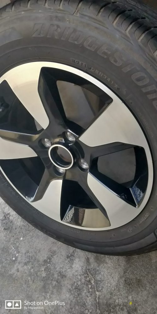

Living the Nexon Life would have been easier had there been no frequent punctures in soft Bridge stone Turanza Tyres.This is the 5th puncture so far.
I love the alloys,and I love the 215 profile tyres provided as OEM on Nexon.
People upgrade to 195 section tyres on polos and Figos and swifts etc,and call them good and sporty. Here Tata has given 215 section as OEM spec. So I am more than happy about it.That was a big- big factor in my choice of Nexon over other cars. I have a special liking for big,large-profile tyres. Maruti in the interest of high mileage provided 165 section tyres in my Swift.
But there is a negative aspect too,as these tyres have a soft compound,which gets puncture often.Today I pulled out 2 nails from the tyre.One of them was over 2 inches in lengths.Already I have mended 5 punctures in my Nexon.

They don't get punctured?!!??? I mean whats the thing that doesn't let them get punctured?, their material? Or something stuffed inside?
My friend ,you jumped the gun too early. I meant to say just the opposite,along with sarcasm. Please read the quoted portion. I know you mean well,so thank you for your concern.

Life will be even easier if you can procure ATs in that side. Tyre noise will increase slightly but wet braking, puncture resistance, off road grip are far superior to soft bridgestone HTs.
BTW yes, 215 is plentiful size, only 20mm less than safari (in width, not height. Safari Tyre is 4 inches taller & has massive sidewall.)

AT tyres on a city hatchback? Just to save punctures? Why would I do that?
The whole ride will be spoiled. I don't do off roading. Its a city car,for crying out loud.
ATs are meant for SUVs,campers,pickups,4wheel drive vehicles etc etc. My car is none of those.
Noise will increase drone like.
Fuel efficiency will decrease.
More risk of cupping on ATs
My main issue is noise.A steady growl will be heard at any speed above 25km/hr, and will never go away even at higher speeds when wind noise usually overcomes the minor noise of Bridgestone highway tires. On paved roads, compared to AT tires, HT tires will give longer tread-life, better handling, and shorter braking distances, in both dry and wet conditions.
Also, as already mentioned HT tires have lower rolling resistance than AT tires and therefore will provide better fuel economy.
So its simple for me.No unnecessary experiments.
I can understand your post was intended with a very good intention of saving me ,from the agony and frustrations of punctures,as I myself pointed out. Thanks for that.I appreciate it.
