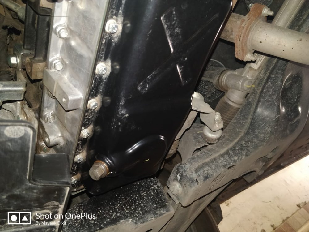

Now that the rains are over,I can look up the oil leak problem properly. After repeatedly going under the car I have concluded that about 500 ml engine oil has been lost. And the leakage point is that same copper crush washer at the sump bolt.Maybe half of that got burnt up(new diesel engine). Since there is no margin to tighten it further,I will have to loosen it and then put up a new washer from the spare parts bin. In this process oil will be lost further and it can be changed too.

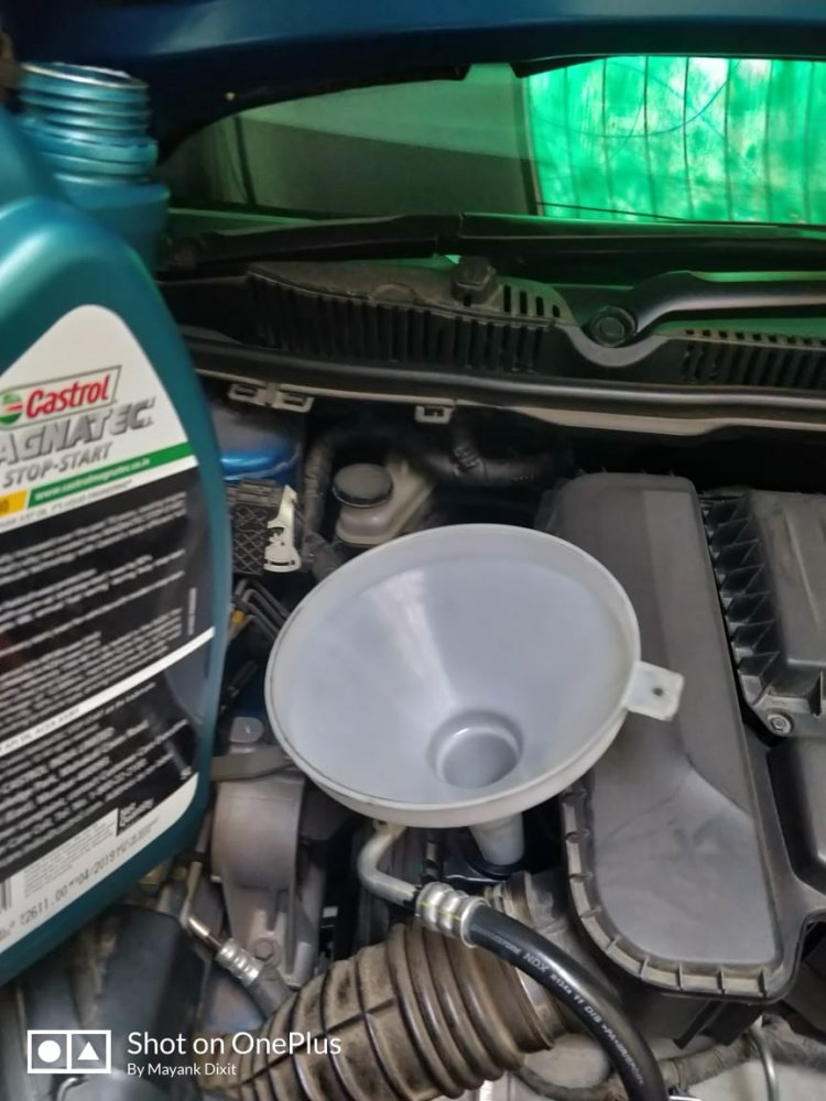

This is the oil spec (5W30) fully synthetic, I will be using in my Nexon. Quantity is 5 litres. Surprisingly it is recommended for both petrol as well as diesel cars!!
This matches Tata recommendation,as in the owner's manual.Nobody new at the retailer shop about this 5 litre packing.They all were blissfully unaware thent diesel nexon needs 5 litres!
This oil is little pricier than the Tata brand oil available at the ASS.
Oil meets API SN grade + A5/B5 category as recommended by TATA
The pack says fully synthetic oil

I have gone ahead and changed the engine oil and oil filter of my Nexon, myself.

The culprit of oil leak has been found .Its the warped copper washer,abused and reused by the service centre folks.
New and old washer side by side.

I have driven 100 kms already post the oil change. I have found out that
1) oil leak is ZERO. The sump plug is dry totally.

This is the new copper washer sitting flush with the base

I got the time to check up on any further oil leak. There was none.
I was afraid ,but thankfully the workmanship is OK so far.
