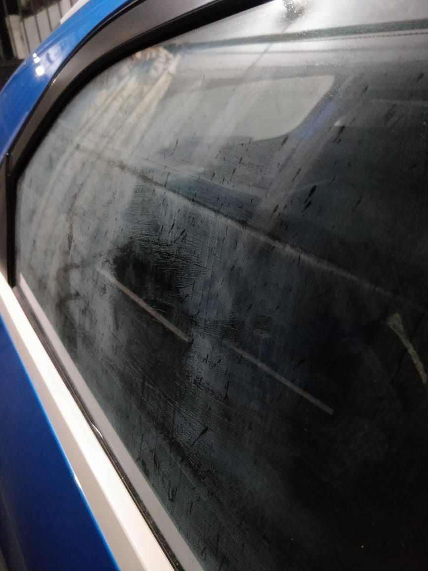

Suddenly I am facing lots of frosting and condensation issues. Now the rain has subsided, so condensation should be less. This is from the inside of the glass. It is very difficult to remove the water from glass completely . It simply has a tendency to return within 1min.
Side windows and rear hatch are involved more than the front.
I think it should not happen from Inside , but looks very strange for me. is it due to excess Humid? or something else? curious to know the resolution info Mayank bhai
Mayank try this the next time, as now the rains have subsided, and condensation will occur only from next month when winter set's in.
For the hatch window, use the defogger switch, and for the rest of the glass area, put on the A/C fan on fastest mode, and full heater mode, and the air direction on the front windscreen, the condensation vanishes in seconds.
Hope this helps.
[roll]
Of Course it's due to excessive humidity collected in the cabin. I cleaned my glasses with colin and aired out the cabin by leaving the windows open for 3 hours straight this sunday. Now I do not see any condensation at all.Hope it lasts.

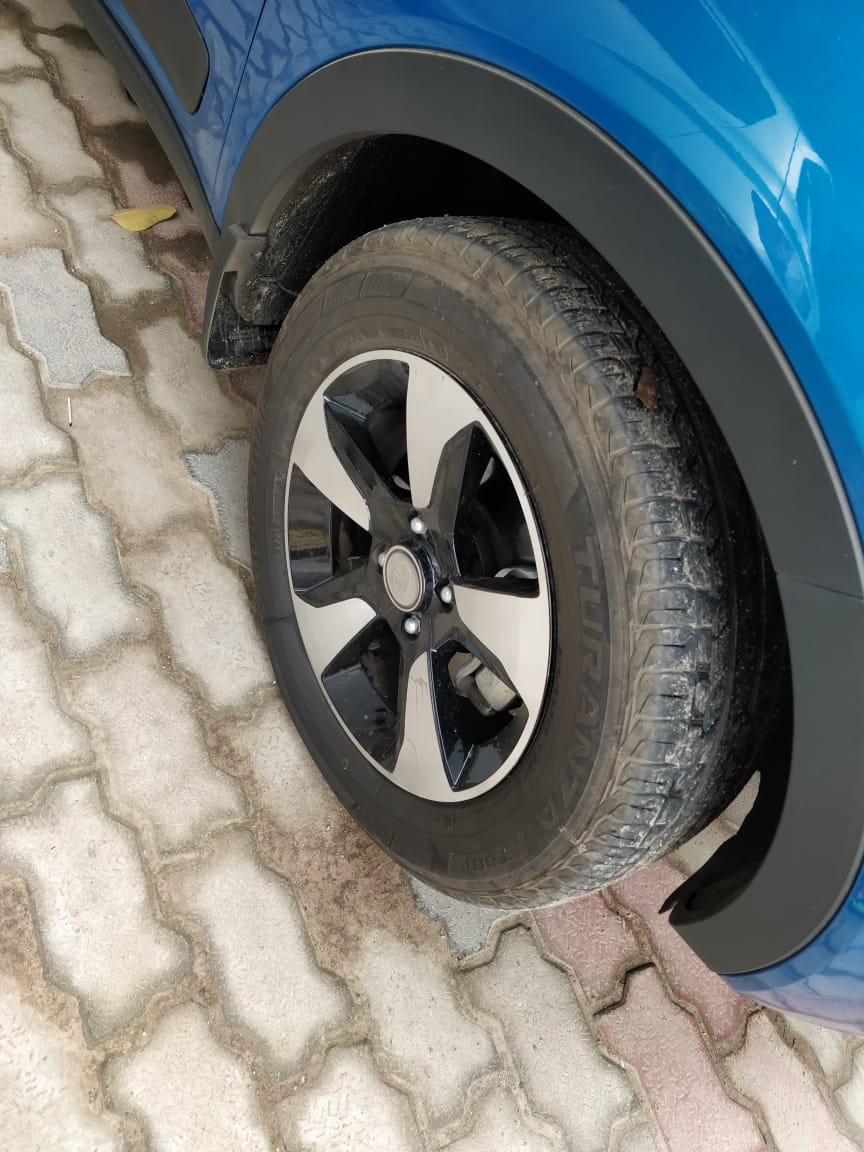

Just wanted to share recent pics,taken after a long run in the city.
I just adore these 5 spoke alloys. They suit the car very much.Design is simple and very easy to clean.

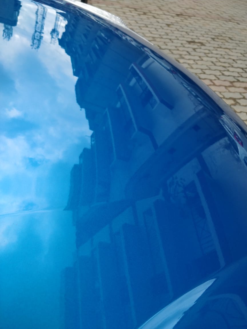

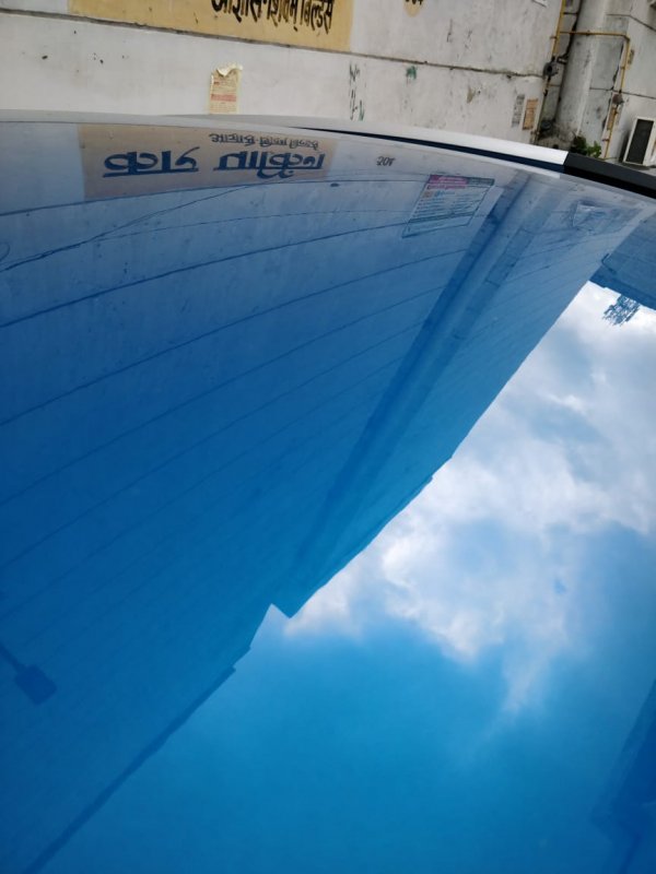

It's quite some time since the last cleaning session and still the Polish is holding up good. If it lasts further I will get more laid back and then I will do it once a month only.

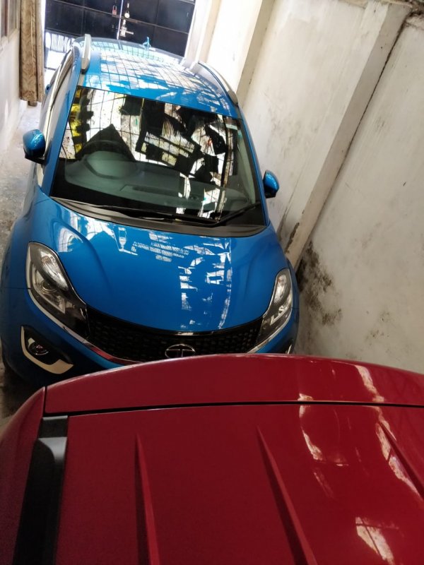

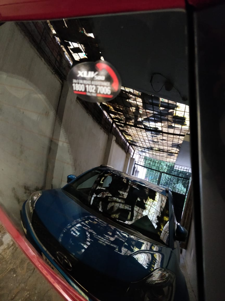

Wanted both my cars in a single frame.Its difficult because there is no space in the gallery.Its long but not wide.
watching over the younger one
You are in my reflection
i am following you
reflecting in the rear windshield
not much gap between us
I can not drive both at the same time.So I try to do it alternate days.
