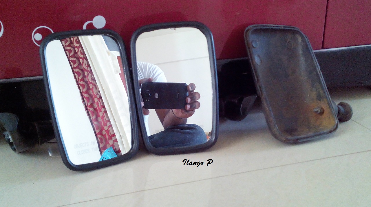

Still I had kept my eyes open scanning for a side mirror from another vehicle. Spotted Piaggio Ape and Avenger mirrors which were very much close to 118NE side mirrors in their shape. Since it is a chrome plated part a pair of Avenger mirror was too expensive for the budget I had fixed, I eyed on the Piaggio Ape side mirrors.
Went to a tempo parts shop and to add to my confusion, there were 2 types. One with socket for a ball joint in the back side (the ball is a part of mirror stem) and other with a ball and a small stack with a nut (the stalk fits in a square slot in the mirror stem). As they cost only Rs40/- each I took 1 of each type. Decided to go with the second option which came with the ball joint included. Bought 2 mirror stems, chopped them off at the required length. A friendly lathe guy machined 2 cones to adapt the stem to 118 mirror base. Welded the 2 parts and again got them levelled on the lathe. The rubber protectors from the Ape mirror stem came handy in hiding the weld job and the nut behind the ball joint. The result is evident from the attached pictures.
The rubber base for the mirror are from my old broken mirrors. Had 2 extra pieces. So got a mirror for left side as well. Drilled similar 8mm holes on the left doors, placed the mirror base rubber with self-locking arrangement and fitted the mirror for left side as well.
