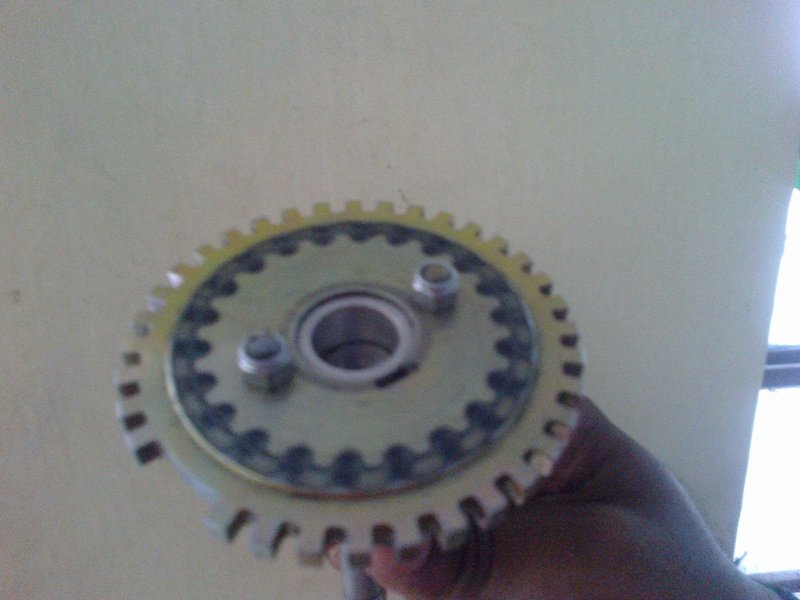

Attached some pictures of the Laser-cut wheel.
A reference from this site Tech Wiki - EDIS : Datsun 1200 Club says that is it difficult to install the Ford wheel (9 mm thick) behind the Nissan crank pulley. Mine is 6mm thick. Not sure if it would need some machining to install it behind or the last option is to install it in front of the crank pulley. Will be going to my mechanic to understand the fitment options. But I am worried with option 2 as the sensor needs to placed with a long cantilever extending from the crankcase, which may or may not induce some noise in the generated signal.

Crank wheel installed
After a long pause, finally found time to get the 36-1 crankwheel installed in the car. The space behind the pulley was extremely cramped. With the crank wheel there is only just enough space for wheel to clear away from the engine block. The mechanic had to remove the radiator and the fan for removing the old pulley. Got to figure out how to fit the crank position sensor. Please see attached picture.
