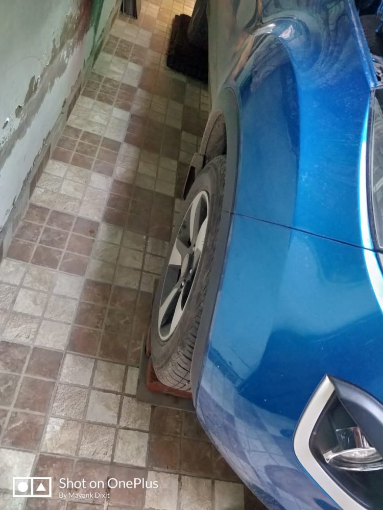

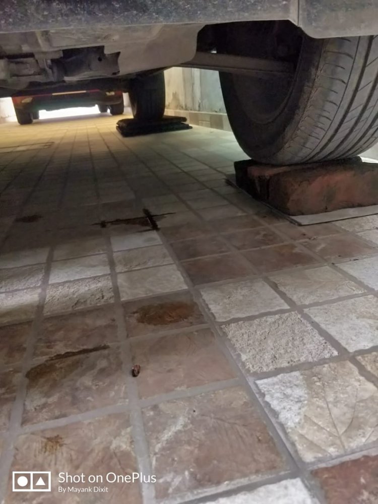

Since I am scared of getting crushed under my own car,I used solid brick elevation of 5 inches,instead of using jack stands(I am having 5 of those)

Similar to front I used thick doormats for rear elevation
It is going to be messy
Tile + brick elevation
Now I can easily crawl below for my work

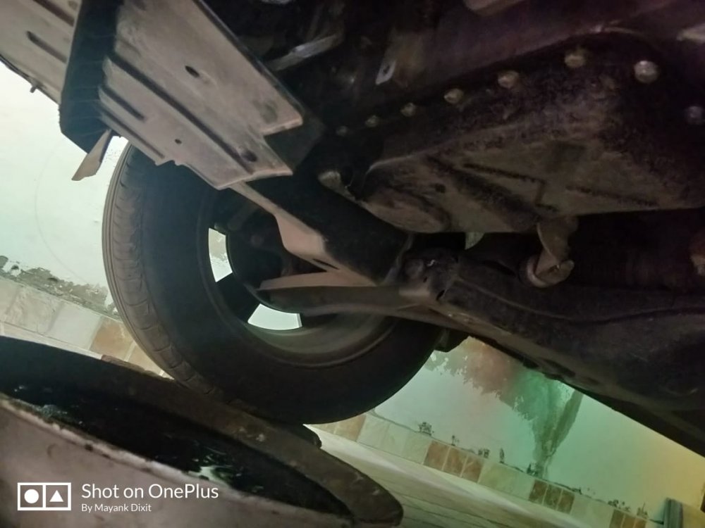

dirty oil drained fully

Old used oil with reflection of the sump

How did you get those bricks under each tyre? Jacking each wheel must've been tiring. Or did it climb up in gear?
Don't feel bad but I laughed all day on your innocent query. I know no one can guess. The car can easily jump on these bricks and more if required, no issue there.The problem is while climbing the bricks rotate and violent turning action of bricks actually...
1) Damages and breaks the bricks into pieces(done that)
2) Damages car underbody and yanks the mudguard(done that)
3) Damages the costly tiles and cracks them.(yet to do so scared about it)
So I use trolley jack here,which lifts the car front like a baby, in 5-6 seconds only with little effort.Then I put the bricks neatly,and then I Lower the jack and withdraw the jack.This I have done numerous times in XUV too.
This is not tiring at all.And I have two of them.You can have a look at them here if interested: My trolley jacks and also here : Also my trolley jacks
