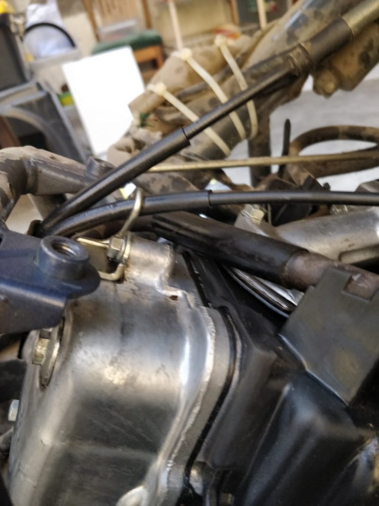

Whenever I opened up the engine bay of my scooter,I found it to be smeared in oil.After careful inspection,I concluded that the head gasket of my 2016 Honda Activa 125 was leaking oil for quite some time.I decided to replace it in my home as a DIY project. I procured new gasket from the Honda ASS.It was not costly at all.Tricky part was to find out if actually the gasket was leaking or the leak was somewhere else.
I cleaned up all the oil and grime and opened up the head cover.I proceeded to pull out the old gasket and put in the new one.i used gasket RTV sealant for this purpose.

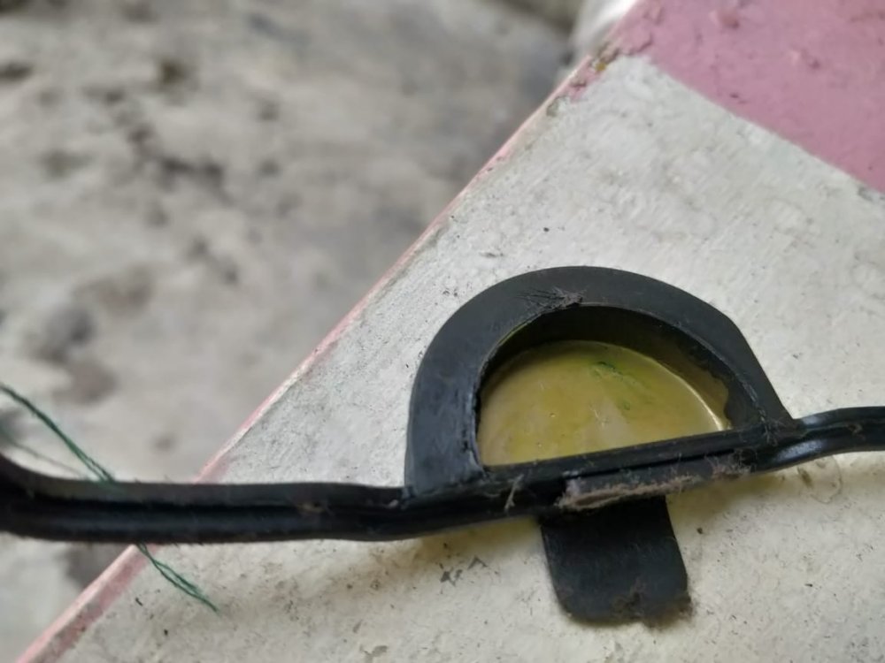

This is the culprit Head cover gasket which was causing problems.On inspecting it closely I could not find any cuts or abrasions or tear in the rubber.Also there was not a single place in the perimeter which looked to be weak or poorly sealed. But point to note is that After changing this gasket oil leak has mysteriously disappeared furthur giving weight to my correct diagnosis.I inspected the area after 50 km driving and it was squeaky clean.So all is good and DIY was successful.
