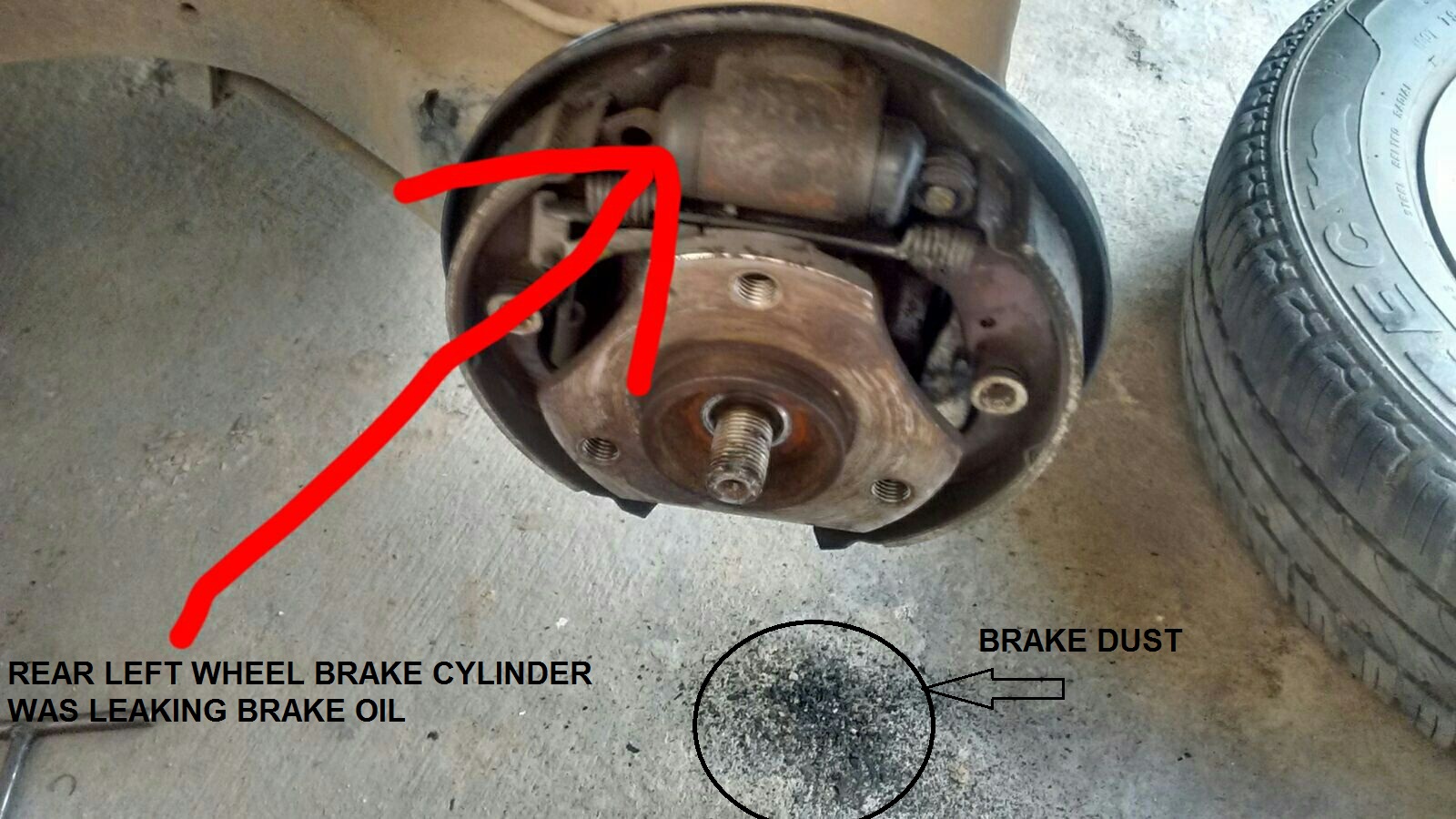

All this part replacement was a pure DIY @ home, or should I say right outside home. Then came out a new issue - Leaking brake cylinder in rear wheel. Luckily, a friend of mine went on a hunt for the leaking cylinder, with a pic on his phone. Managed to get a TATA original spare (I'm saved).
