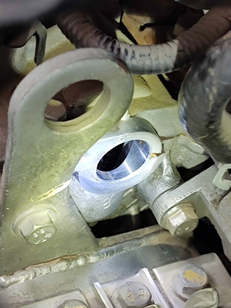

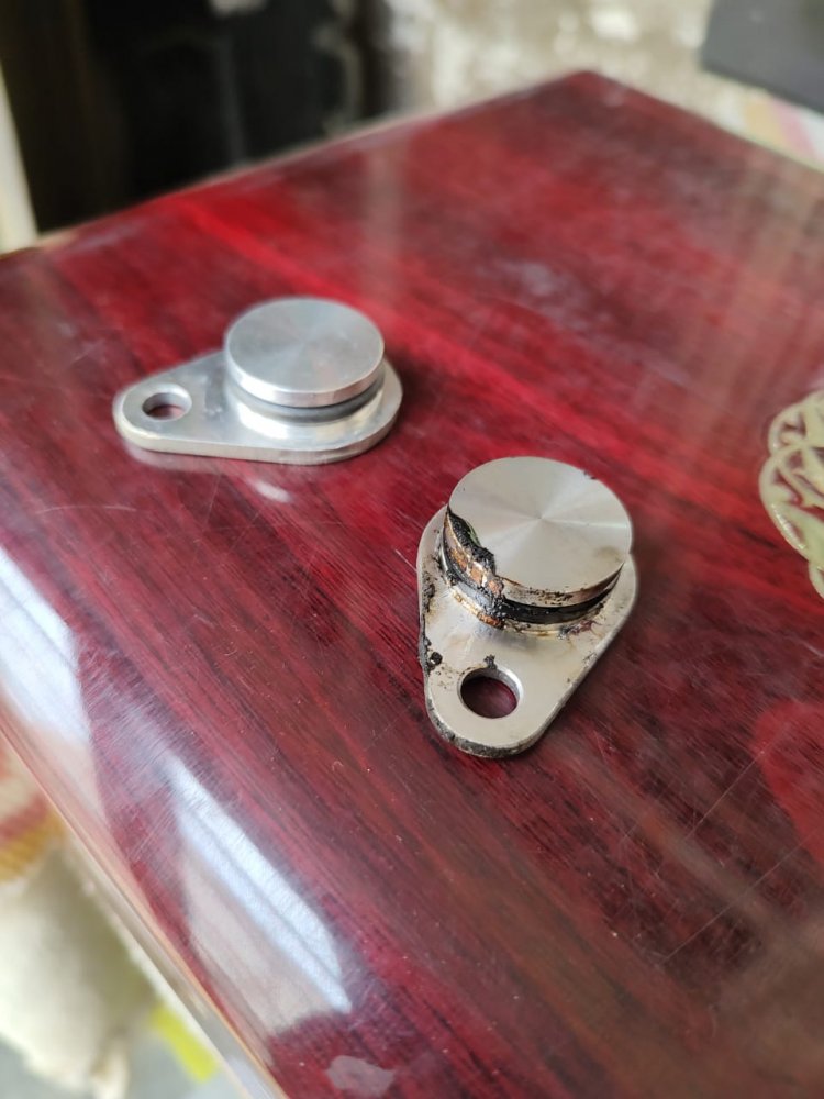

Engine oil leak in my XUV500 from rear cam cover, and DIY repair
For the last few years I had been noticing engine oil leakage near the head gasket area in my XUV. I discovered it myself during routine inspection of engine bay area. I pointed it out to the SA in ASS during next routine service. They just tightened the (already correctly tightened) bolt holding the cover in place. That did not stop the oil leak at all. Despite of repeated reminders in subsequent services ASS staff shrugged off the problem as minor, and tried to scare me by saying that "lots of parts will have to be removed to access the head gasket where the leak is present". I believed them as I had very little knowledge at that time, and it appeared that the head gasket is leaking and since the leak was minor, I did not pursue it further fearing that dismantling so many engine parts( including intercooler and its attachments) might create new niggles and rattles etc.
But this oil leak remained in my mind always, and I tried to find the solution myself. During research and analysis I realised the leak is NOT from the head gasket but from rear cam plug/cover, and no large scale dismantling of engine parts is required .In fact that cover is fully removable and its designed that way only as an inspection window !
I suspected that the O-ring inside the cam cover is defective causing the oil leak. Since this reduced a lot of burden on my mind ,I went about changing it myself at home as a DIY project. But I was not sure of the results. This 2021 Diwali I had a window of 6 hours to complete my DIY.
Pictures of DIY
engine cover removed
oil leaks from this cam cover
intercooler intake
removing the defective cam cover. This was very difficult as it was badly stuck to the engine
Camcover removed. Lots of dirt and debris around
Old and new camcover
Damaged and leaking O-ring
New camcover plug with O-Ring
After thorough cleaning
New plug/cover installed
Dirt that was wiped out on my old t shirt
New cover has different markings than OEM
Old part stored just in case...It had no visible imperfections.
Old and new plug comparison. I only suspect the O-ring, otherwise both parts are identical
Some more zoom-in pictures of old and new parts:
This is new
This is old.
Old cam plug being pulled out
Thank you for patiently going through my DIY and pictures. Hope It will be of help to some XUV500 owner, member or not .
Pictures of DIY
intercooler intake
View attachment 290560 View attachment 290561 View attachment 290562
View attachment 290566 View attachment 290567 View attachment 290568
View attachment 290571 View attachment 290581
View attachment 290580 View attachment 290579 View attachment 290578 View attachment 290577
This is new
This is old.
View attachment 290573 View attachment 290572
Once again a wonderful and detailed writeup along with pictures.And a note on the old part with date too.
Hats off for the tracking details.
But my question Sir,from the picture the old cover has no imperfections.Then what could have been the cause of the leak.
Puzzled
Thread Starter #359
mayankdixit
May 16, 2014
1,891
3,371
kanpur
Puzzled
I think the O-ring is defective(manufacturing defect). I did not take any risk and change the whole plug/cover itself.

Follow up of DIY repair (Engine oil leak in my XUV500 from rear cam cover)
I had that leak too, I guess the ASC just opened it, applied some Gasket sealer and the leak went away. .
After driving for about 100kms I rechecked and was relieved to find no oil seepage from the rear cam-cover. I will still keep a watch out for it whenever I open the engine bay. So far it appears that DIY is successful even without any use of gasket maker.
