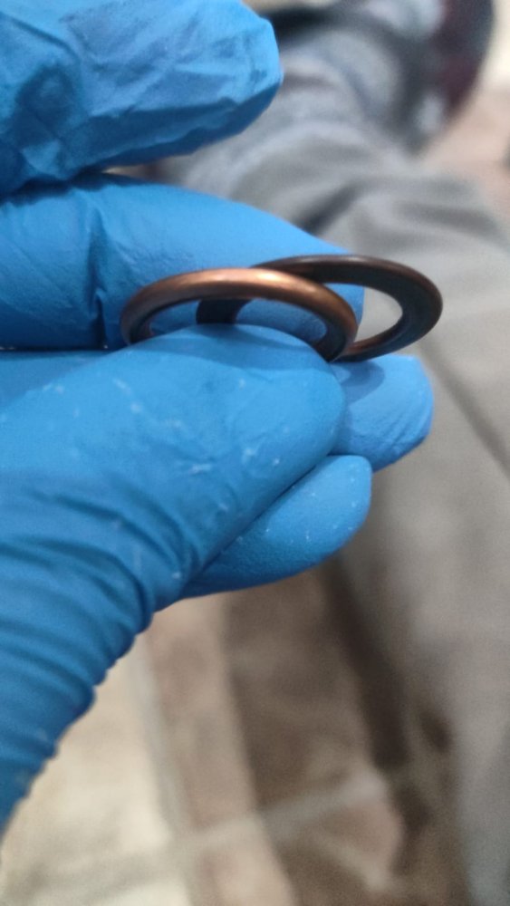

Old and new copper crush washer.
I have a good supply of new crush washers. Need them all the time.

Crush washers compared. New one is thicker. Old got crushed , obviously.
