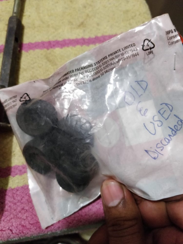

Yes, the engine plastic cover was the culprit. These bushes were totally cracked and shredded. These bushes are not costly at all. But they are very difficult to procure. Nowhere in the local market nor at the retailer could I procure a complete set. ASS asked to bring the car and put it up in demand.
Meanwhile All night I was repeatedly checking the steps of oil change,in case I have done something wrongly in my DIY . Guilty mind you see.
On changing these bushes the sound simply disappeared. I am relieved,more so because the DIY had nothing to do with it!! And I can continue on with my routine work.

You even pack and lable the old and discarded parts, simply impressive.
