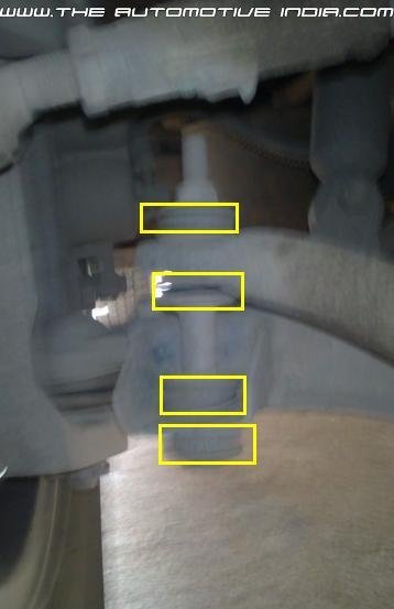

Even after keeping the vehicle at Krishna car garage for more than 2 weeks, the play in the steering is almost the same. Any suggestions guys to reduce the play in the steering? I certainly do NOT want to go back to the same garage. I am thinking of taking it to the TASS unless somebody wants to suggest a better and reliable option in Pune.

Dear Umalkars, please check yourself where you can see some movements check tie-rod, the connecting Rod control, idler arm, idler arm bush, steering joint etc. Check with engine off and with engine on. easily you can find out the trouble. also check the balancing rod bushes. [:)]
Thanks @Manipuzhas, will check out these things when I go home today.

Ask someone to turn the steering, and observe from outside,.
please check idler arm for the loose fastener, if the fastener is tight then idler arm bush might be worn, this bush will be available outside TASS also, an you can fix it in a local garage.
I did it for my old 3.0 Dicor, and worked

You will need to change the central link to reduce the play. So, if after replacing the tie-rod ends and central link the play don't goes then you will have to open the powersteering box and replace the faulty components. That's what happened to my old TCIC Safari and now with this one. Even after refurbishing the suspension, there is play in steering due to something gone bad inside the powersteering box. But, I have now learned to live with it.
