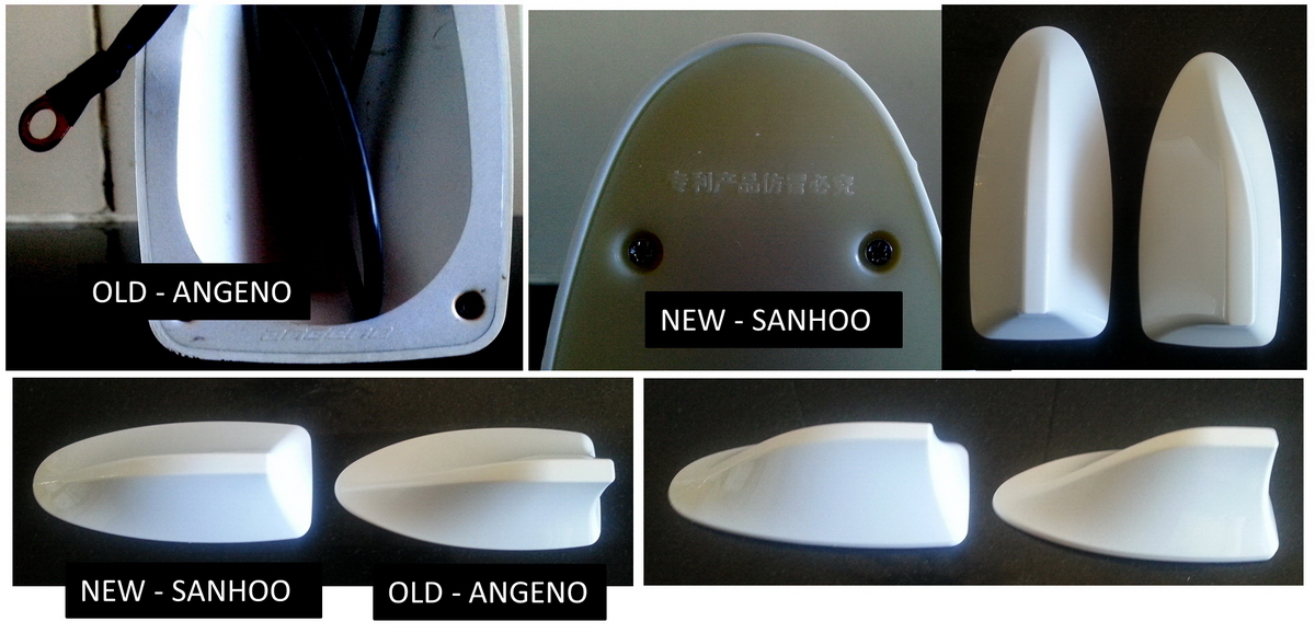

PART: C (100)
MY ALBUS: NEW SHARKFIN ANTENNA
Recently, I purchased a new shark fin antenna to make my ALBUS to look on par with 4th Gen ANHC.
I give my observations here and also what all I did to make it perfect.​
OLD ONE: Newest design special car With blank radio shark fin antenna signal shark fin with 3M adhesive for VW polo Bora-in Aerials from Automobiles & Motorcycles on Aliexpress.com | Alibaba Group
PROS: Branded (ANGENA), excellent finish, Thick shell, Excellent Reception (Even some AM bands I could receive clearly)
CONS: Internals – made out of metal spring and copper wire, look crude; Base is not curved, shorter design but Ok to get placed. Paid @13 dollars
NEW ONE: Car shark fin antenna FM Radio Signal Plus for Cadillac/VW /Ford /chevrolet/Nissan/Peugeot/Toyota/lexus/Honda/KIA/Hyundai/buick-in Aerials from Automobiles & Motorcycles on Aliexpress.com | Alibaba Group
PROS: Branded (SANHOO), Very Good finish, Base is curved -sits properly, longer design- almost looks like OE, and internals look premium, Good Reception, Cheap @ 7.35 dollars
CONS: Thin shell (May be good to receive signals), AM bands are weak (Seller has indicated this), leaves an opinion to a consumer like me that it is weaker than the one I purchased earlier.
As I wanted the new one to work still better, I removed the internals from old one to add the same in place of the new one for better reception if possible. But, I did not do it as the new one picked up and started working equally well.
Recommendations:
This new antenna what I and CRACING purchased is good and value for money. If you are in weak FM zone or keen on other Radio Bands like AM stations, you have to go with the OE (Rubber_Ducky_Antenna) only or ready to make some homemade modifications.
Debugging is important / test before you stick this antenna on the car roof, when the signal is fine and then paste it.
If your car is not an ANHC, please choose and order the rightly designed base for the car roof – Curved of Flat type.

NOTE:
I even thought of making my own internal spring and wire to put into the new one to make it better,but later I found out antenna spring is not just a spring and it is a science. The quality of the reception is based on lambda (wavelength), OR f (frequency) (m) OR (MHz) and it in turn depends up on the design of spring - D (Diameter)(cms) / Z (Characteristic Impedance)(Ohms) / G (Antenna Gain)(dBi).
…he he… stopped exploring further as the New Antenna started performing well to my satisfaction.​
