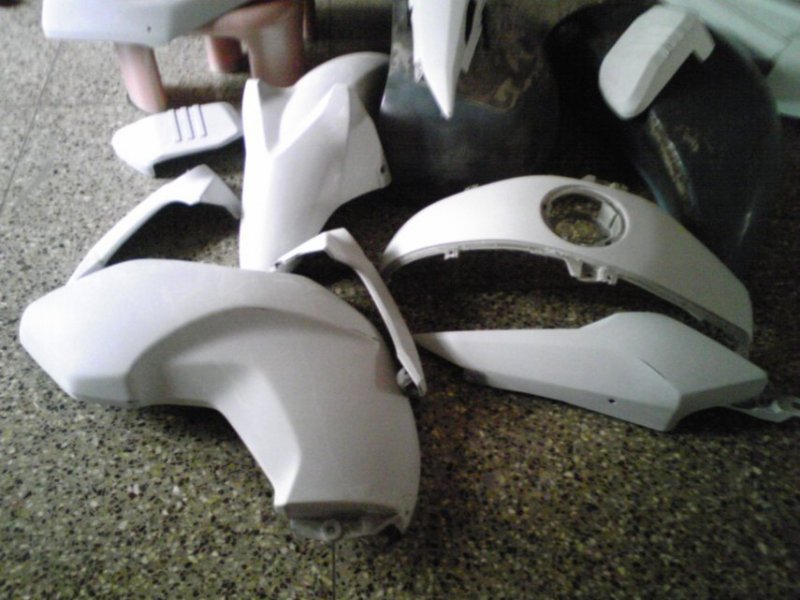

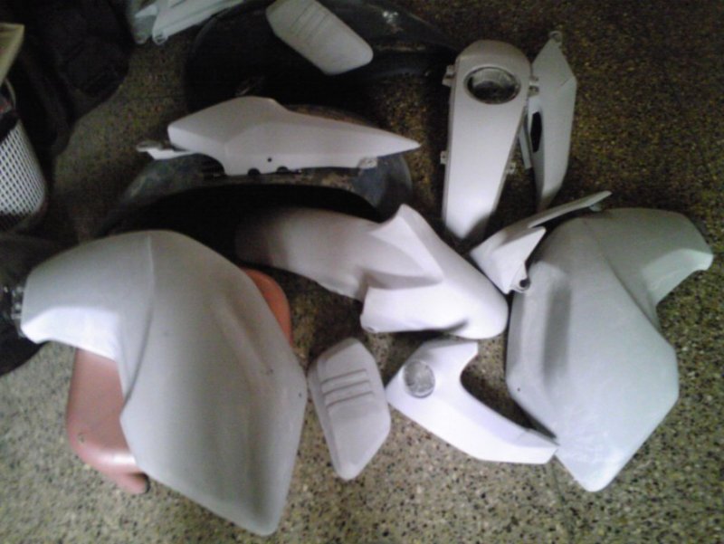

Attached Images of whats on your way soon
