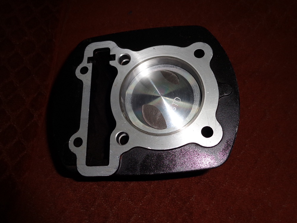

As Promised Here The Here the Pics of 1st Set of Performance Upgrade

Congrats Vishak for these Mods, i have few question here please reply if possible .
1> Since now(i hope) you are running on 200CC bore instead of 153cc , Do you think Crank shaft has enough strength to handle such heavy mod...? or are you planing to upgrade to better crank shaft ?
2> Are you planing to do porting ?
Now The big bore is 182 cc
The plan for going to 200 cc was dropped as one of the reputed tuner suggest that with the stock valves the 182 is enough
The crankshaft is stock and is strong to handle the ripping from 182cc
The head will be ported though that wont happen now
Now I am Palnning to get the 32mm Racing carburetor after which the head will be ported along with a Tuned Free Flow Exhaust
