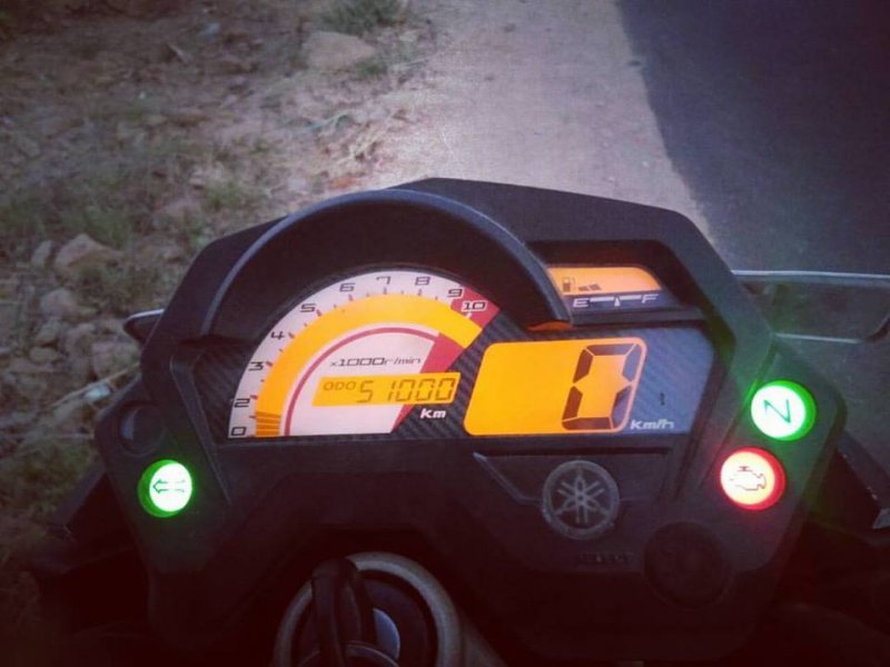

The odo stands now at 49+kms and the digital has lost its charm.Now rpm indication goes blank at certain positions in the rev range.
