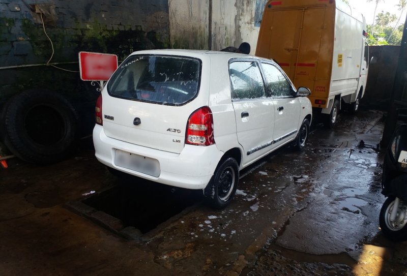

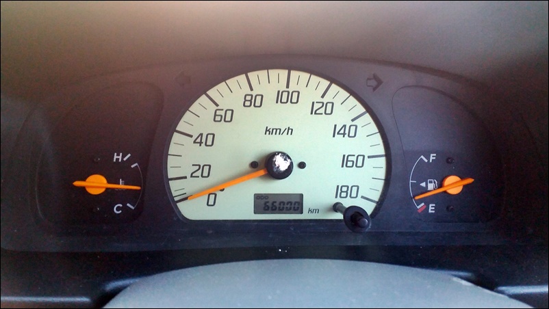

Crossed 64500+ Kms, Gave her a full wash, under body too. Self taking a bit long at times irrespective of cold or hot starts. Will replace Sparkplugs, as its around 20k now and need to clean the fuel tank breather tube,its blocked as per my mech as am getting fuel smell outside the car after a drive..Attaching some pics.[:)]

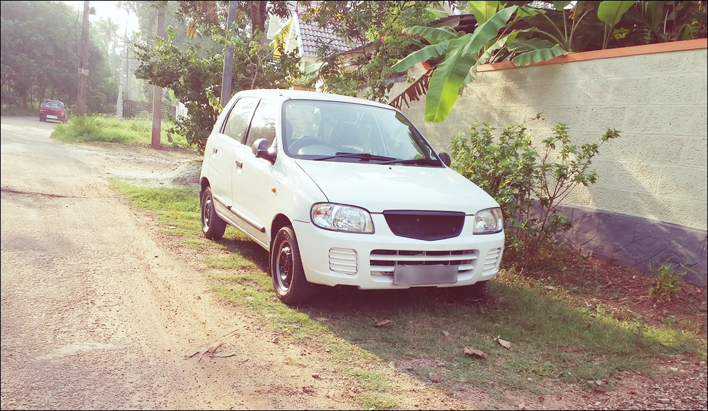

A click from today's drive.

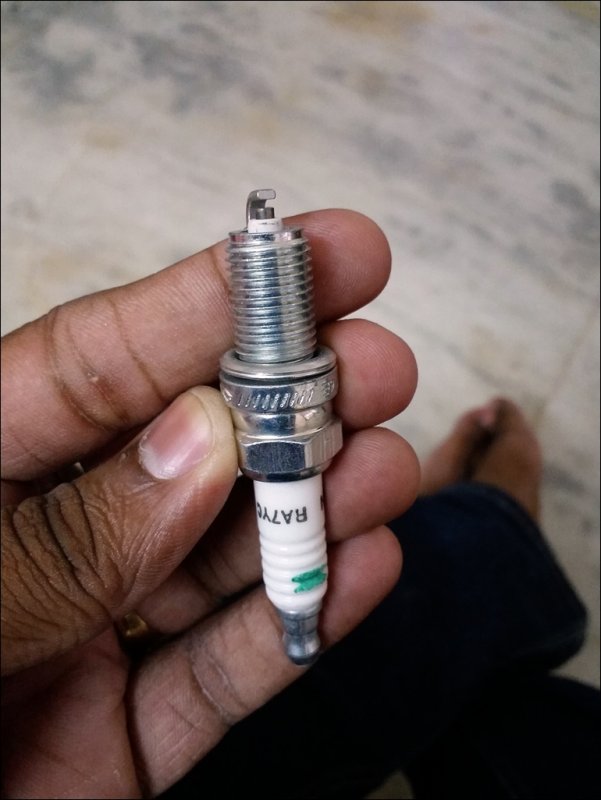

Bought Spark plugs, OEM NGK was 125RS a piece and was out of stock, so got OEM Champion. 70 RS Per Piece. Plugs were changed around 19000kms back. Lets see.

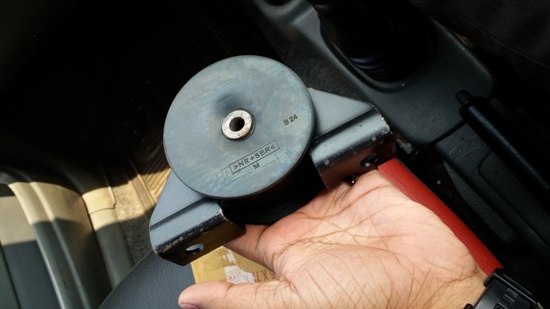

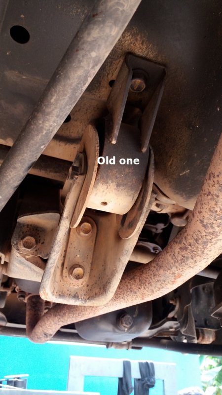

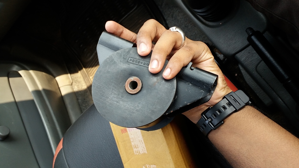

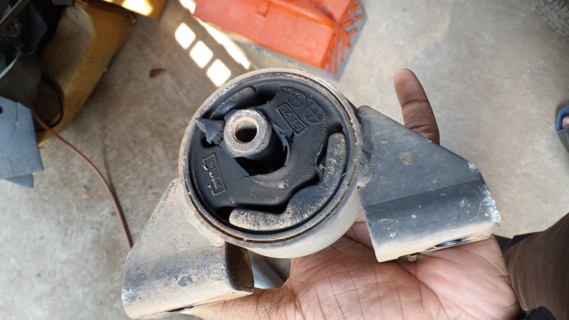

Something was making metal to metal contact noise when decelerating and at times. It was the Gear Box mount bush, was damaged, Replaced with new one. 365 for the Bush plus 100rs Labour.
