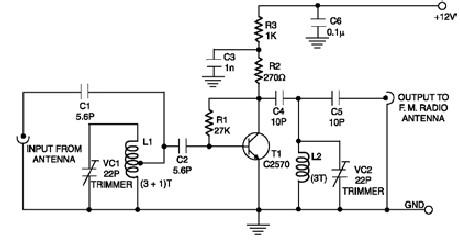

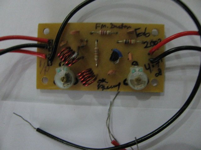

So, I am planning to make FM booster for my car stereo. I hope it will work well. Controlling disturbances caused by two wheeler, auto rikshaw, and in car electrical interference is a problem.

What range do you expect with the Booster?

Hi, About 100kms.

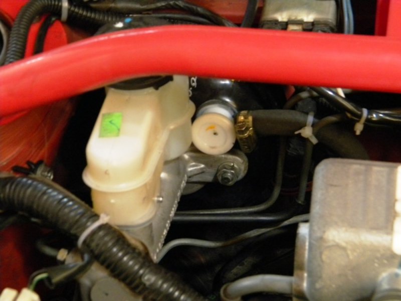

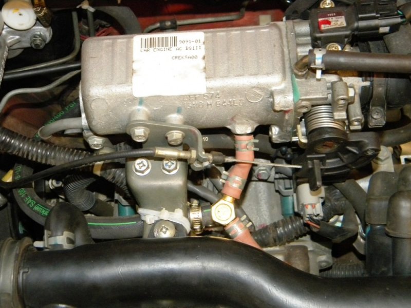

Finally I was able to connect "Brake Booster Kit" for my Maruti 800. It was a long wait. Mr.Varun sent me KBX Booster Kit and somehow after a weeks delay I got it. Varun called me many number of times. I really appreciate his kindness and valuable suggestion made my Maruti 800 more safe on road. The final outcome was fantastic. I had Maruti Wagon R earlier which had booster brakes. Presently my tiny Maruti 800's brake manner has been changed totally.
I searched for "T" joint in many hardware shops locally. No one had it, and after " googling" for hours , finally decided to visit my neighborhood "Gas stove repair shop". I was shocked to see, two types of joints , one "T" and another " Y " joint, both are in brass..! [clap] And I purchase the second one for Rs.25/- and it was perfect for my purpose.! Later I took my car to my friend's garage - "Bhat's Garage" in Yeyyadi, Mangalore. Mr.Harish, lead mechanic cum owner fitted the booster within one hour. He drained DOT brake fluid and changed it to DOT 4 specification as per Mr.Varun's suggestion. Out come...FANTASTIC.! Thanks a lot for Mr.Varun,SS80, and Jarpickle..

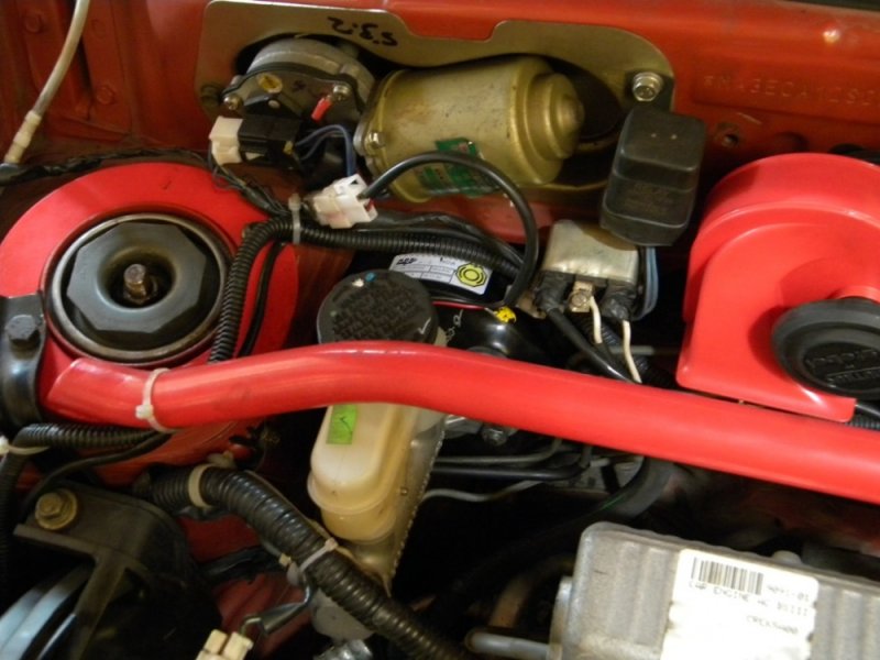

Thanks, it looks perfect ! Did it require to remove the strut bar ?
BTW : which is that relay located on the booster. I wish to see the entire engine bay, post a pic.
So do you recommend booster to other 800 owners ?

Brake Booster is an asset for Maruti 800 owners.
I have not removed the strut bar to fix the booster. That relay is for horn - Stebel, which is next to that relay. Excellent quality horn.
