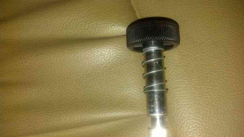

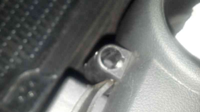

here is the gear lock, the male part of the lock has a spring on the top which makes a slight noise on extremely bumpy surfaces. the 3rd pic shows the female part which i call snap where u place the lock while driving. The noise is caused because of the spring. Adding a layer of thread should solve this issue.
