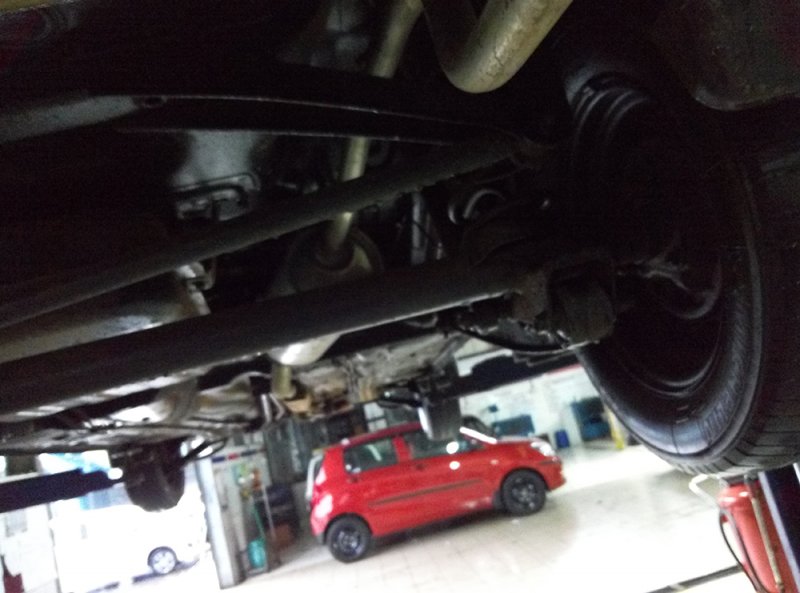

Hi Guys,
There is not much updated but for now the car is at the ASS for rust proofing, but the body shop guy found the under-body of the second row entirely rusted, I asked for the platform change but it would be very costly, they suggested to replace rusted places with sheet and put sealant and after painting it. I opted the later and waiting to the car delivered. Most probably tomorrow.
My car is completing her 8th years on road BTW. is the under body coating prevent future rusting? or what is the things I should care in future? advises needed
please post some pics of rust, repair it and give a good underbody coating,See my latest pics on my thread,used 3M Underbody,done at my local workshop.[:)]
