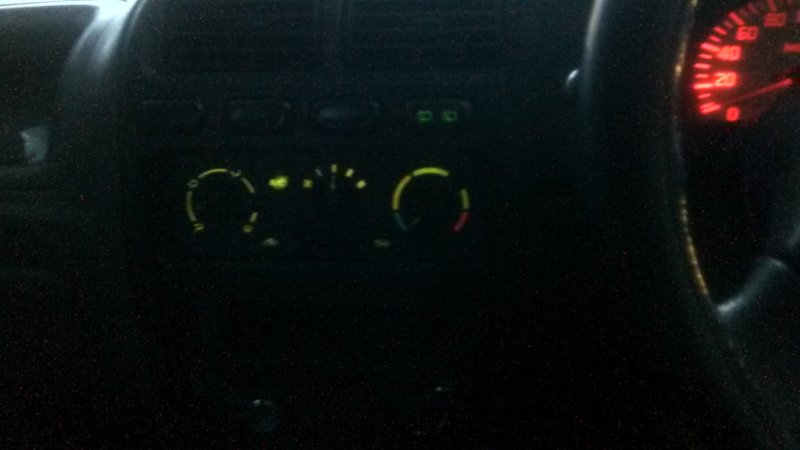

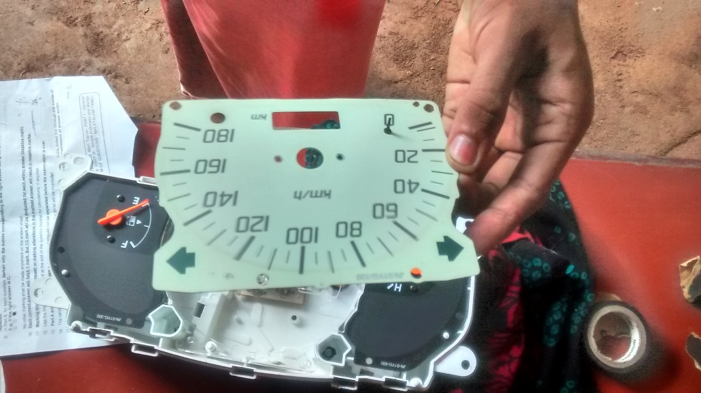

I had changed back-light of my Altos meter console to Red. First I thought to have a separate thread but somebody in TAI already done this and as there is no room for a new thread, I am sharing the details here.
First I was changed those bulbs only, but the brightness was not like the stock setup so I removed front panel and removed green coloring from that using sand paper.
Sharing some pics, please have a look
Wow! Well done buddy [clap] you have done very nice and neat job. You car looks stunning.
BTW who had done it before [thinking]

As you guys noticed. the bulb is prominent on 20 and 160 marks. I need to spread light instead of pointing to somewhere. What to do, Advice please

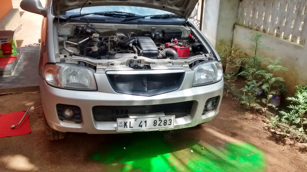

Covered 60k this weekend
Last month I went to ASS to inquire about the 60k service, but as the car aged 8 years, they insisted to do 80k Service instead. After discussing to Devil and Varun about this matter, and with their advice's I decided to do 60K service as a DIY. Brought parts as per the manual from MGP. took 3 hrs to complete the whole things, but at the end of the day I smiled with satisfaction.
Shell Rimula R1 3 liters- 780
Parts Brought from MGP
Air filter
NGK plugs
Oil filter
Orange color bulbs for the meter console
Concentrate Coolant 4 Litter ( 2 litters are enough with 50% water)
Total : 1350 + 780 = 2130
Before removing Air Filter Box
Essential parts for the service, Tyre removed for the better access to oil nut
Plugs points are deep, Needed a large 17mm box to remove
Preparation of oil filter fitment
Oil filer fixed
Tightened with the wrench
Flushed radiator
Cleaning with water and filled coolant with 50% water, but after flushing and filling, I heard a gargling sound from behind the dashboard while starting the car, I removed radiator cap after idling sometimes to remove air bubbles and filled coolant again!
Meter console color changed to orange to sync with tachometer!
I took this pictures in my mobile as I don't have a proper camera and anybody there with me to help, but there is detailed thread with each steps on oil change DIY from Aneesh in TAI to help! Please do search [:)]
