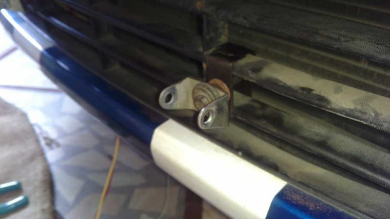

Last sunday, My Blue boy got some High beam assists!
These are special Lamps with a zoom lens in front that produce a VERY tight spot straight ahed. The spot at 2 feet distance is JUST 6 inches round. That should give you an idea how tight the beam is. Comparatively, Factory high beams spread the spot to about 18 inches wide.
A new relay harness was installed to sap power directly from battery and the trigger was joined to factory high beam cable. So as soon as High beam is turned on, these bad boys come on as well.
Each lamp uses 50w halogen bulb. I must say that safety has increased a LOT after this mods and a few flashes are enough to make others dip their beams for me.[evil]
As usual, I followed the unique No-drill no-fuss install method by fabricating special brackets that grip the bumper slats.
