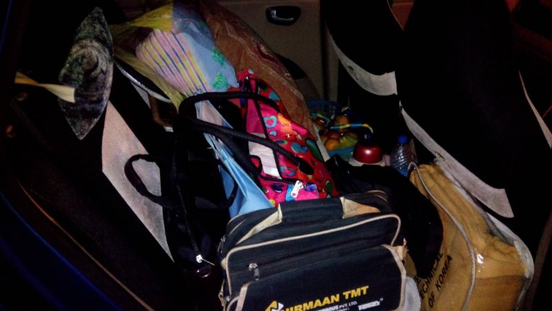

3> We were 2 people with Full load of luggage as you people can see. Both the Hatch and rear bench was full.
