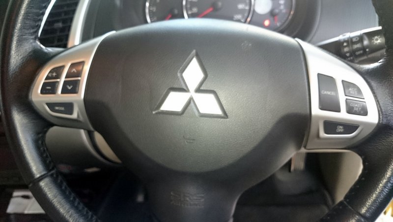

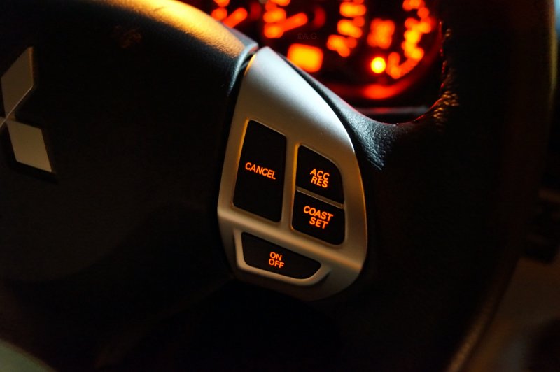

Additions Part 2 – Cruise Control Installation: (December 2014 + October 2015)
A couple of days after purchase, while searching for the service manual for the Pajero Sport, I came across the thread for installation of Cruise Control (Link). Somehow, I was unaware of the thread of Iron Rock and checked the wiring in the steering wheel as described [frustration]. After seeing the wires planned on installing it. Researched further and found that the parts are common with Outlander and Lancer Evo both of which had been sold officially in India. This opened the possibility of a dealer install and it became a priority mod now. Communicated the part numbers to Excel Motors during the 1st service and got an absurd pricing. During the visit to Vivek Autolinks for the rear entertainment issue, the parts were ordered. They got the parts in first week of December 2014 and I got them installed at the first opportunity taking the print of the link along as this was the first install for them. The final total came to Rs. 8,273/-.
Over the time, I noticed that if clutch was pressed accidently with cruise engaged, the engine revs would rise and would then fall back to idle after disengaging the cruise. Referred the service manual and found that cruise control for manual transmission needs a clutch detection switch also. The part number could not be found and I dropped the idea. Recently while communicating with Iron Rock, the need for the clutch switch re-ignited. Tried all routes and finally found the part number in one of the picture showing all 3 parts. Immediately checked with Vivek Autolinks and all hopes were lost as the part came with the name Switch Stop. Still, took the plunge and asked them to get one as in pictures in the link above, it looked quite similar to the existing Clutch pedal stop nut. After delay, they finally got the part in October 2015.
The real trouble was in locating the connector to connect the switch. Before the switch came, I tried really hard even with a camera to locate the hidden connector but could not. The dealer tried and they too could not locate the connector. Once the part was in hand, all efforts were put down and the connector was located hiding on top of the beam supporting the dashboard. After that, it was a simple replacement with only and important care being taken to match the position of the stop bolt on the switch with that of the removed bolt to avoid the need for calibration. This third part completed the cruise control for the MT [:D].
Completing the look on the steering
A close-up of the cruise controls

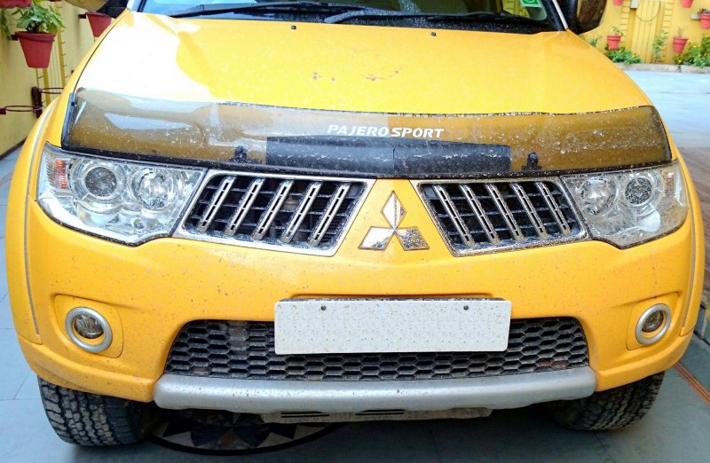

The Second Service was done at Vivek Autolinks, Ghaziabad at 10,359 Kms in March 2015. The switch to synthetic engine oil was also made bringing the total bill amount to Rs. 14,033/-. The rain on the return journey after service ensured that all the efforts of cleaning & washing were going to be washed away.
The dirty pictures
