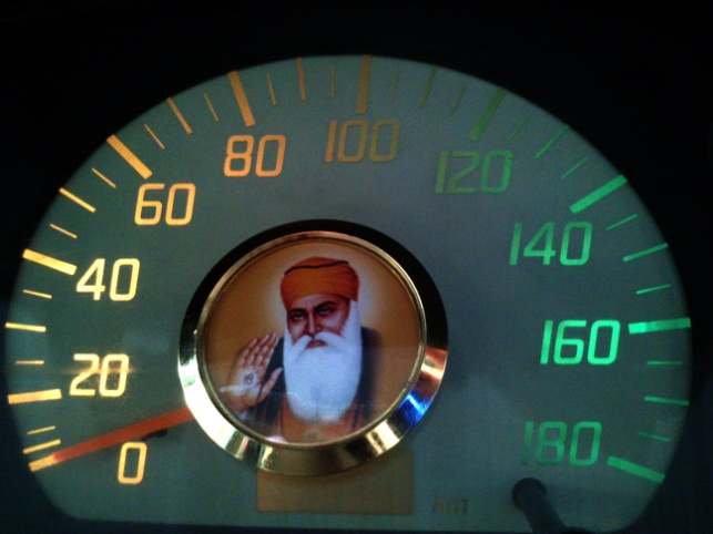

Hi guys ! In an alto speedometer panel backlight has orange color light. We can change it's color. It is not as easy because along with desired color bulb you need to scratch the backside yellow color on the marking label . Carefully scratch only yellow area ,don't touch the side indicator area. Purchase desired color bulbs from market, can use LED bulbs also.try different color combination also and coose what you want. Enjoy[glasses]
Let me know how you remove the speedo needle.[surprise]
